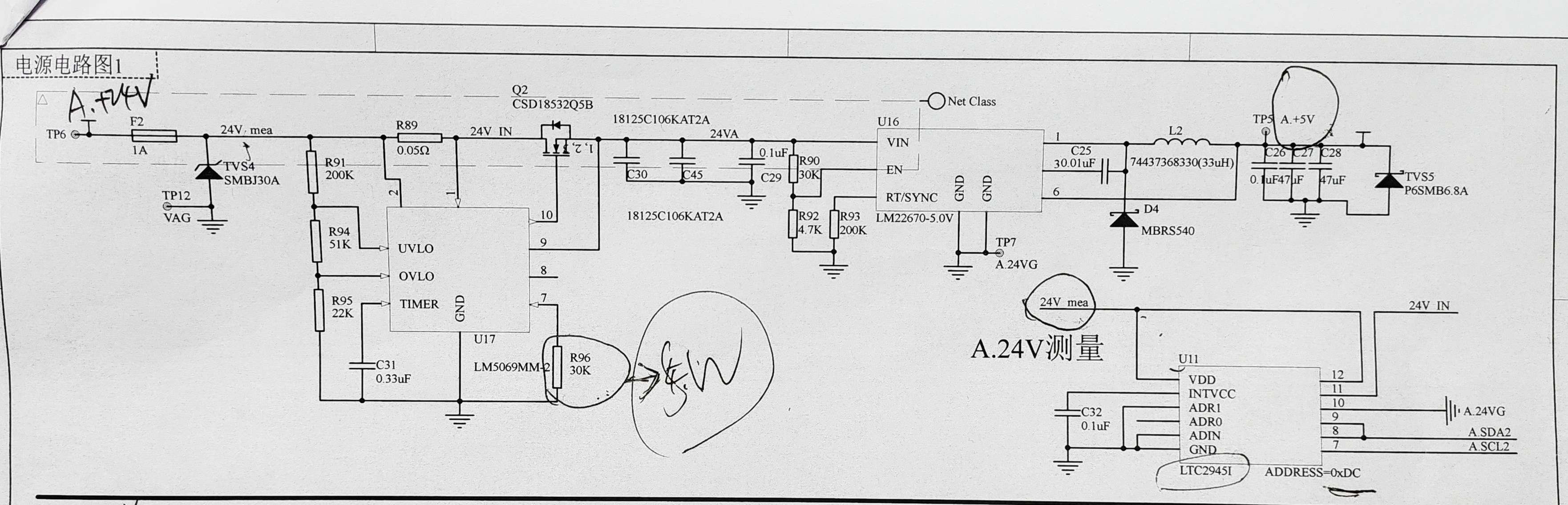

We are using LM5069-2 as a 24V input hot swap. Recently, it is found after running some hours, the 24V output of LM5069 circuit could be dropped off to 0V and then it will become re-started to 24V. Since the same 24V is also used for other boards. Every board has LM5069. And only this board meet this issue. We suspect if there is any over current or power limit. After check, it looks the current limit and power limit has enough margin and the load could not trip it. So, we wonder to know, for this phenomenon, is there any other event or clue we should check?

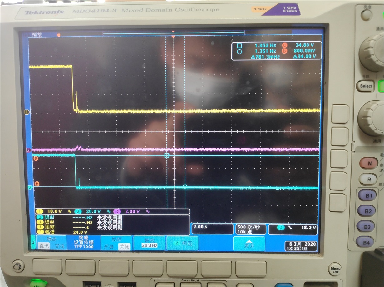

    Can you also capture test waveform of GATE,  Vout, timer voltage and input current during turn-off  by keeping oscilloscope in trigger mode on GATE high to low.

    The issue could be re-produced by raise ambient temperature with a Heat gun of 70°C. See below waveforms of 24V, Timer and Gate. The chip become down and the timer voltage seems not correct. The chip could not be re-actived by power down and power up. Keep the board powered off for a night. Then, the chip could be actived and re-start to work in room temp. But once heat it, the issue repeated again like above.
    However, so far, this phenomenon looks happened only on some chips. And for other chips, it does not happen this issue. So, it looks there is some spec is temperature sensitive. Such as: we do not see current sense reference spec over temperature range. Would you please help check if there is any characterization data? We hope to get some clue to find out this issue.

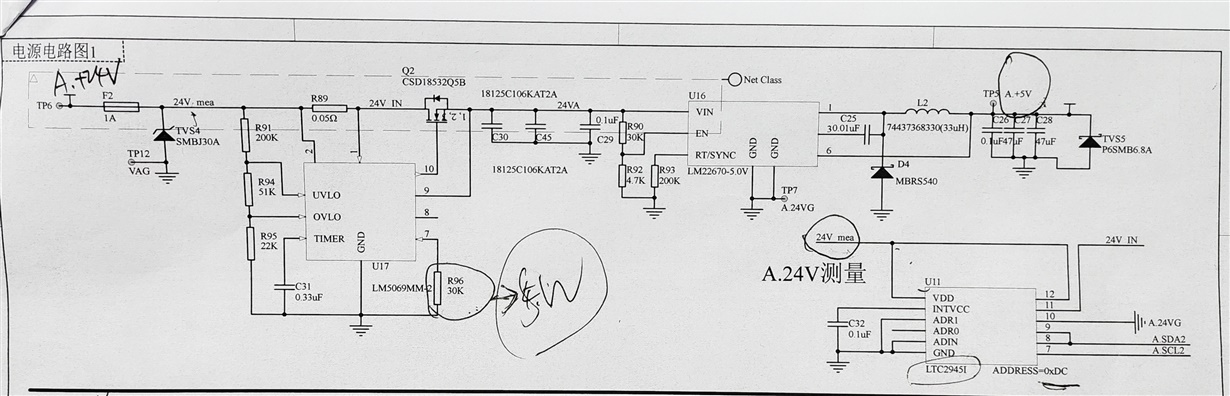

    The sch is here, the real load is within 300mA. The current limit is set at 1A. Power limit is set at 5W for start up power limit.

    The current limit is set at 55mV/50mOhm= 1.1A (typ) and the typical circuit breaker trip point is at 105mV/50mOhm = 2.1A.
    Please refer Figure 13 in the datasheet for the current limit threshold variation with the temperature. It is pretty constant over the temperature.
    Few questions to debug..
    1. Can you zoom-in with 5ms/div scale to see what's happening. 2s/div is large..
    2. Do you expect pulsed current of >2.1A from the down stream ?
    3. Have you swapped parts having issue to a good working board and tested ?
    4. Is marking on LM5069 on all the parts same ?
