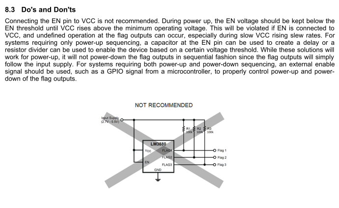

For LM3880, connecting EN pin directly to VCC isn't recommended as follows. So, should this be applied to LM3881 as well?
