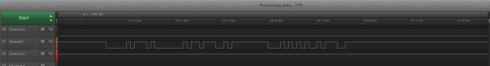

BQ79606A-Q1: Communication Errors between BQ79606A-Q1 and Tiva TM4C123GH6PM
Part Number: BQ79606A-Q1
Other Parts Discussed in Thread: TM4C123GH6PM
I am in the process of programming the BQ79606A-Q1 using the TI Tiva TM4C123GH6PM with UART communications. After reading extensively through the example code provided for the BQ79606A with the hercules microcontroller I was able to translate that into my own functions that could be used to write to certain addresses of the BQ. After using a logic analyzer I was able to confirm the UART transmission of the Tiva was working properly and sending the correct bit stream along with the correct CRC value. I also created a breakout board for the BQ79606A in order to make proper connections to the Tiva. I connected the 3.3V source of the Tiva to VIO of the BQ79606A as well as using pull up resistors to VIO to connect WAKEUP, NFAULT, TX, and RX to the correct pins. I used a multimeter to double check that all the connections were correct between the Tiva and BQ, which they were. After doing all of this I am still unable to receive any message at all back from the BQ79606A. Since I don't think there is a fault in any of the connections, can someone take a look at my code and see if you can catch any errors when initializing the transmission for the BQ79606A, thank you. I will also provide the screen shot from the logic analyzer which used the command " Broadcastwrite(SYSFLT1_FLT_RST, 0xFF); " to test the UART transmission from the Tiva.
