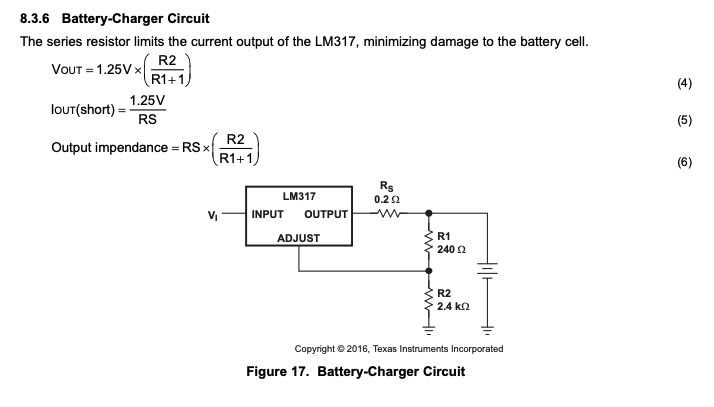

We are using "TPS73801" for battery charging at 11.5V@1A . We assumed that the LDO would limit the charging current beyond 1A  and maintains @1A current. But the LDO is supplying beyond the rated current of 1A.As we checked the datasheet ,the internal current limit is 1.6A. Our requirement is to charge the battery @1A constant current and with this solution we cannot attain it.Please share us a suitable battery charging solution that can charge @1A and the output voltage is adjustable to 11.5V.

  • HI Vishasl,
    Unfortunately, there is no pin to pin. The pinout of the TPS738 is unique and the 6 pin SOT-223 is not a very popular package.
    One regulator that has been historically popular for this type of application is the LM317. A very simple example is shown below:
    One of the unique features of the LM317 is the implementation of its overload protection. The Darlington output stage self regulates to protect the device. Meaning, If the product (VIN-VOUT)*ILOAD is causing the device to get too hot, it automatically throttles back the load current to keep it working. This should mitigate the issue you are seeing.
