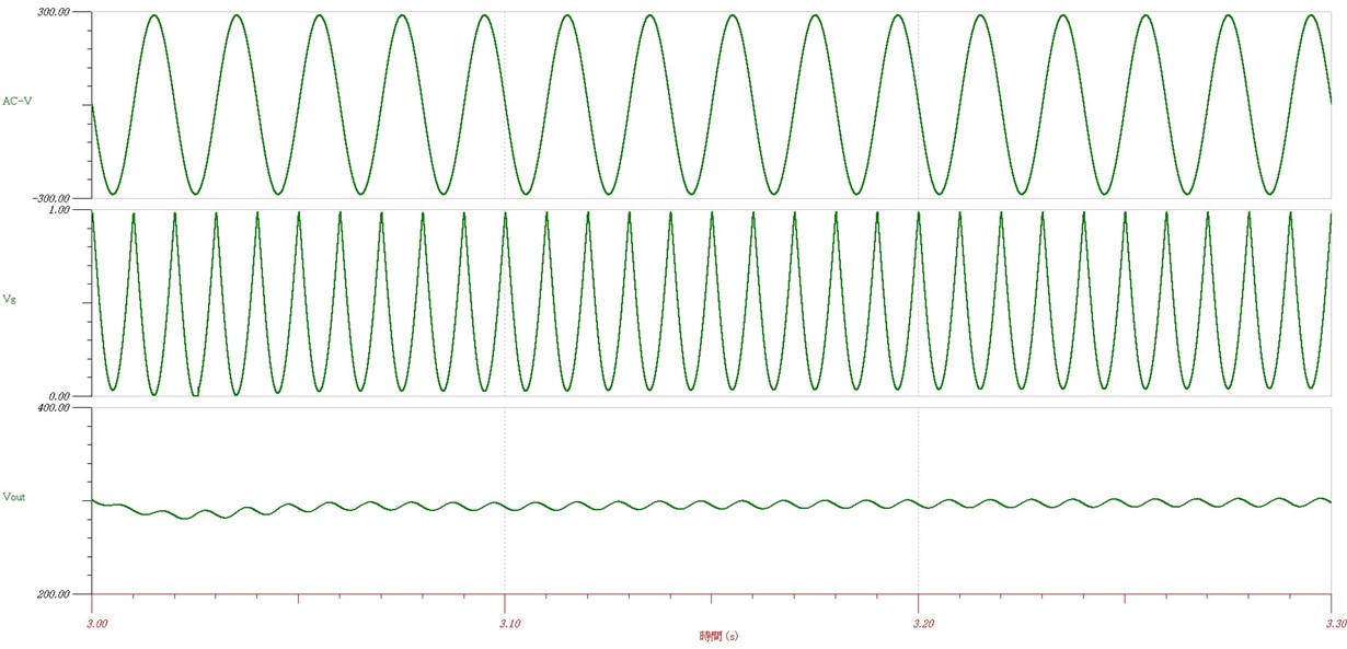

The gate waveform (Vg) of the UCC28180 reference design (SLUM529) is as attached.
Is this waveform correct?
How do I get the correct waveform?

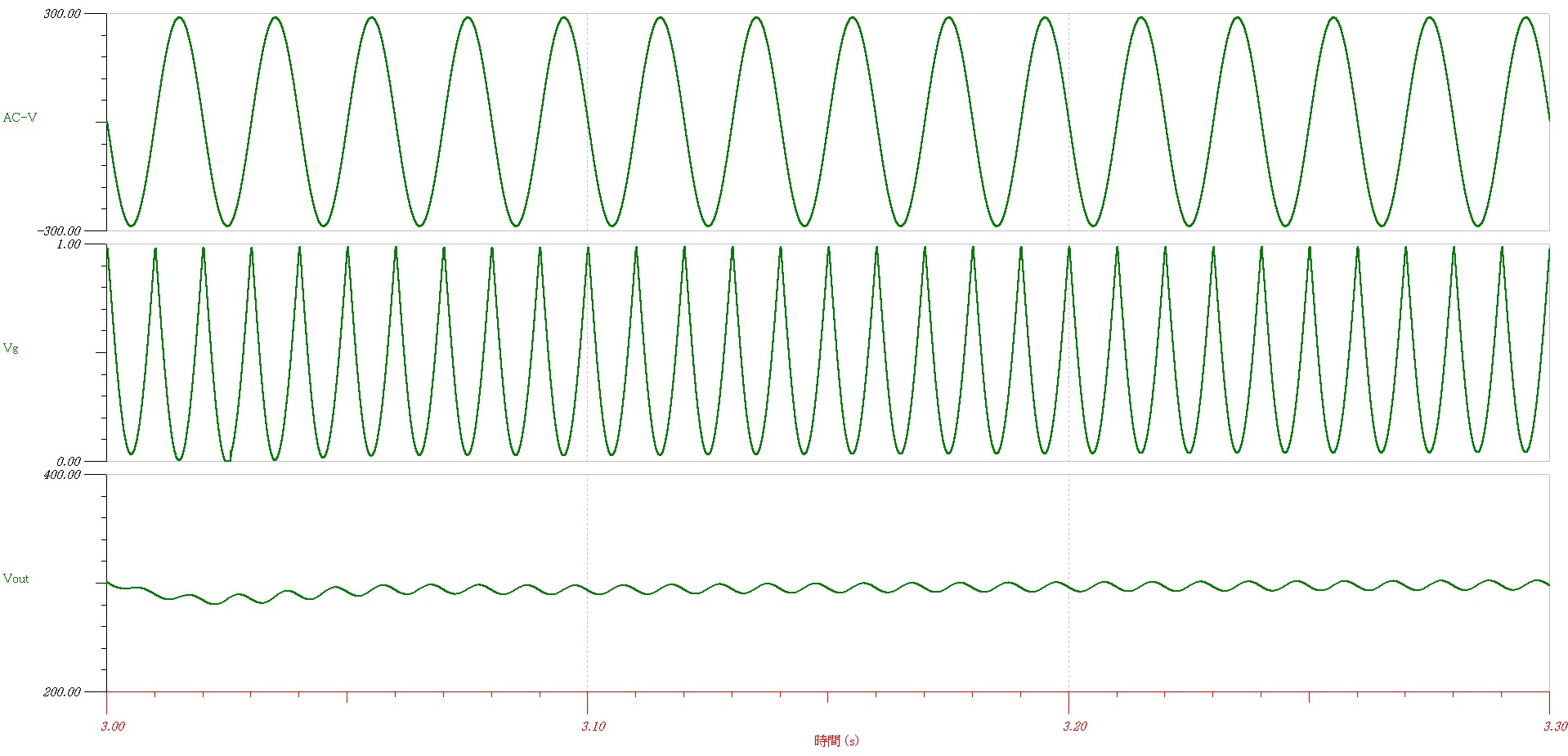

Hi Hirotsugu-san,
The model for the UCC28180 is an averaged model and not a switching model. The average model is like a mathematical model for the controller and the power stage is also an average model, so you will not see a PWM gate drive signal.
TI does not have a switching model for the UCC28180 PFC controller because the simulation times can be very long due to the fact that the switching frequency can be in the region of 100kHz but becaus ethe AC line frequency is low, 50/60Hz and the voltage loop is slow, 10Hz BW it can take a very long time to simulate the circuit and get it into regulation.
The average mode provides much quicker simulation times.
