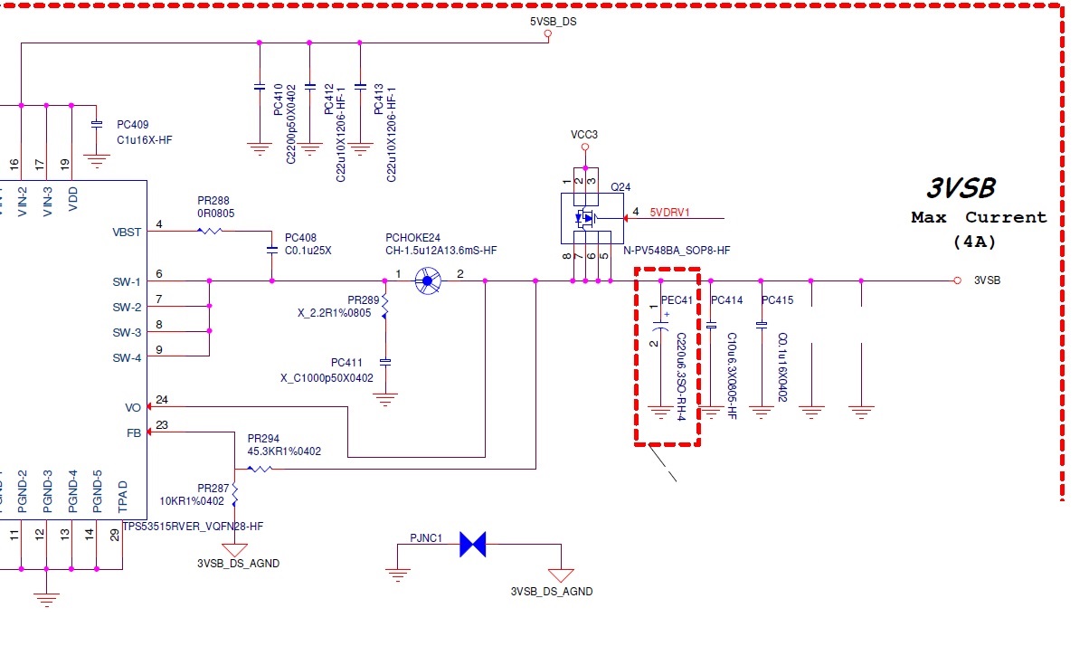

According to datasheet, TPS53515 could support pre-bias startup.
Please find below partial schematic for TPS53515.
If Q24 is enabled, so VCC3 and 3VSB will be tied together and it looks TPS53515 will not switch if 3VSB output voltage is high enough.
Do you see any risk if to parallel VCC3 and 3VSB at the same time?
