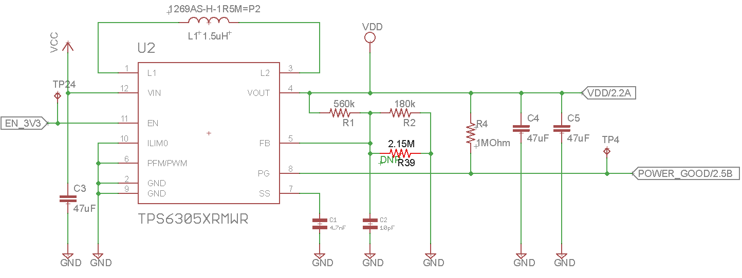

What would you recommend doing to try and revive this board / chip? The schematic around this part looks as follows:
  • Hi Victor,
    The schematic looks fine.

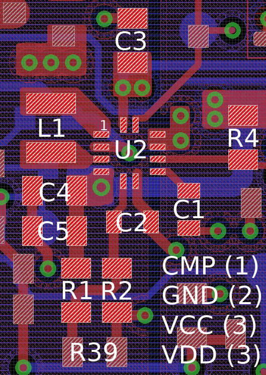

    3. Can you please share the PCB layout? You can just show the part around the TPS63050, showing all the PCB layers.

    3. I will post local layout later, but unlikely a problem as its works,  and has passed FCC / CE testing.

  • Here's the local layout for your interest.

    As for the PCB layout, we recommend having the GND pins of the device and the GND ends of the input/output capacitors (C3, C4, C5) connected in the same layer. Check the recommended layout in the datasheet, section 11.3. I suggest connecting pins 2 and 9, and GND ends of C3-5 on the top layer, and using vias for the inductor. From the device point of view, this creates less ringing in the switching loops, otherwise the ringing might affect the device long-term reliability.
