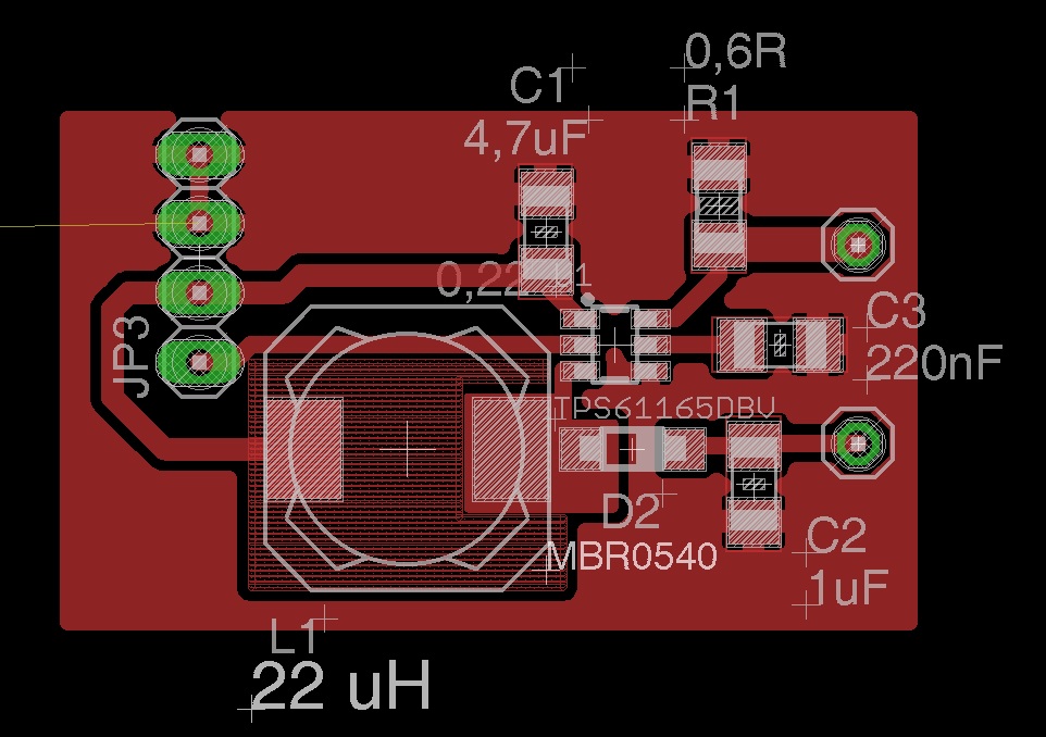

I want a build boost LED driver for 6-8pcs 1W LED based on TPS61165. This device is seems easy to use.
But as soon as i finished first protoboard, i've got a big problem.
My circuit doesn't bost the voltage, and i have no idea what goes wrong.
The input voltage is 12VDC, the output voltage is same as input.
I tried several different inductor value, but nothing changed.
I used my rewok station to solder the parts.
Here's my board layout:
The diode is "MBR0540" which is recommende by the datasheet.
The inductor is "EPCOS B82464P4223M000" (I have a lot of these, so i hope these are ok for DC-DC application)
