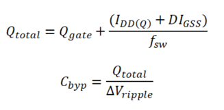

    An easy way is to choose bypass on the order of 100x larger than the gate cap. An even easier way is to simply match the 1uF bypass as used in the Evaluation board design! You'll see how we essentially get this equation from the equations below.
    Brian Machesney said:
    I'll only be driving about 1/3 of the gate capacitance, but at 50X the frequency called out in the LM5114 EVM app note. Should I simply scale the total decoupling capacitance up 50X for dV/dt and down 3X for gate capacitance
    Not exactly that, but frequency and gate cap both affect the choice.Gate cap of the MOSFET you are driving is the biggest impact, as that takes the most current every clock cycle. I think you shouldn't bother too much with decimal points and getting exact values. This is more to estimate the minimum viable bypass capacitance.
    Heres one way to estimate: I_DD is quiescent current in LM5114 datasheet, D*I_GSS is the Gate-> source leakage in the MOSFET datasheet. Vripple will be chosen by you, say you want no more than 1% ripple on VDD for example.
