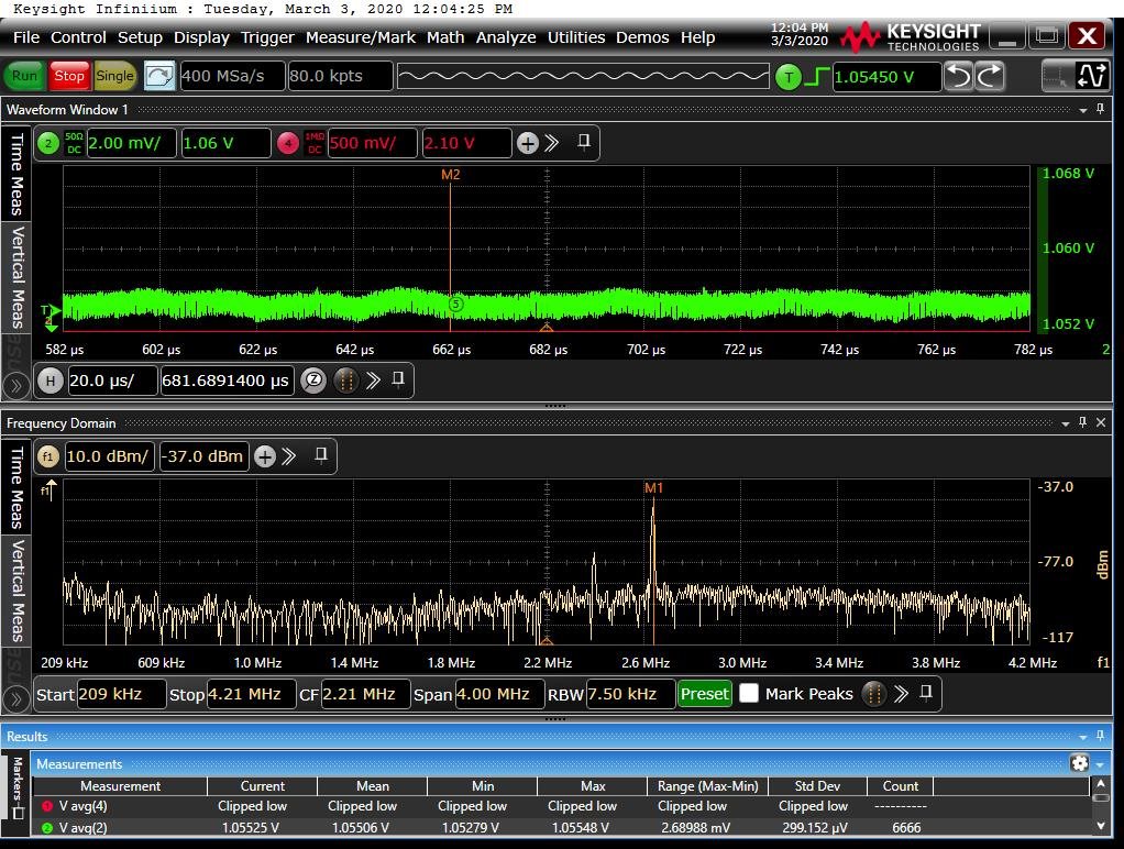

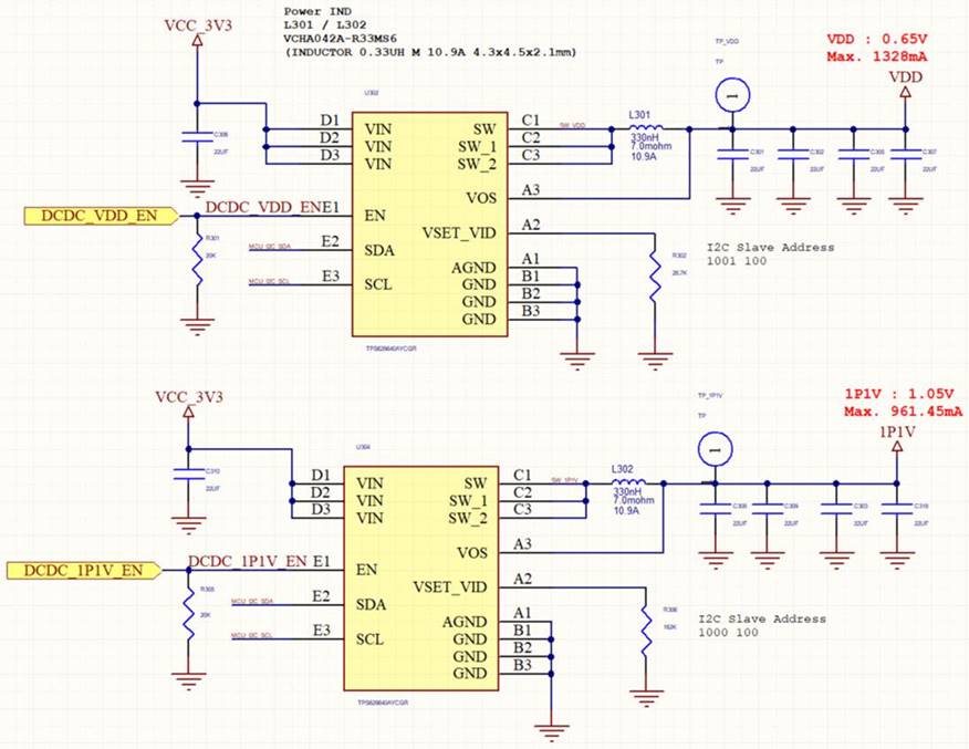

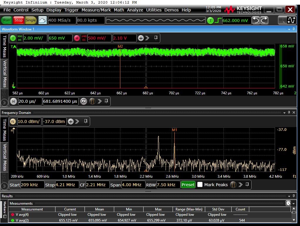

My customer design TPS62864 for 3.3V to 1.05V and 3.3V to 0.65V in his system, the performance is good but have a question about the switching frequency. Customer checked the spectrum then found there are two ripple frequency in output voltage rail. One is 2.4MHz, the other one is 2.6MHz. Customer doesn't understand how come 2.6MHz ripple appeared in output rail? Could team help comment it?
