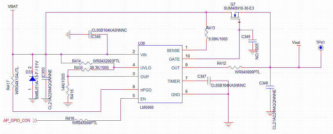

Dear Sir,
Could you help review schematic as attached file.
please let me know any comment for review.
Dear Sir,
Hi Dexter,
What is the application use case ? end product ?
Schematic connections look good. What is the part number of D33, value of C349, Max output capacitance, max Vin voltage ?
Where does the output of LM5060 goes to ?
Best Regards, Rakesh
Hi Dexter,
Schematic looks good.
TPS25940-Q1 would be better option for your system requirements.
