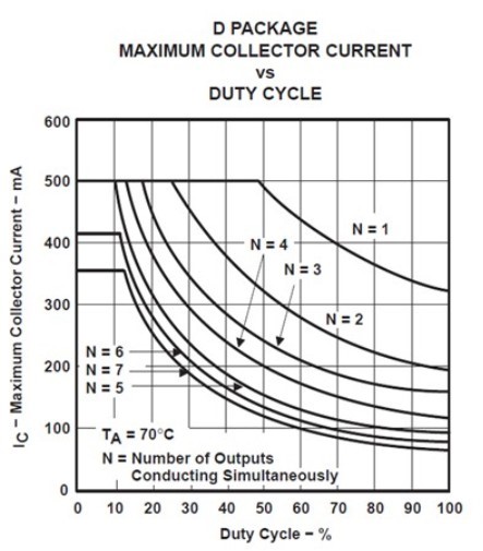

ULN2003A: Small package, 3 channels output and 50% duty cycle to support total 750mA output
Part Number: ULN2003A
My customer use ULN2003A to drive 7 electronic valve.  they need 3 channels output  simultaneously to support 750mA under 50% duty cycle, other channels
but according to the curve below, the peak current of each channel  in this condition can only output more than 200mA current, very close to 750mA margin.
they prefer small package, would you please suggest if this is  feasible? or recommend other device. thanks.

  • Andy,
               1. They used 1 UL2003 to drive 7 valves, 3 channel open at the same time could happen.
                 2. Will check with them tomorrow
  • their working voltage is 12V.
  • Hi Yue,
    Is there a reason why they don't want to use 4 channels from the ULN2003A to drive these electronic valves?
    Using 4 channels you limit each channel to conduct up to 200mA. If output are connected together you could achieve up to 800mA.

  • Andy,
    Actually, they need to use 3pcs ULN2003A to drive up to 17 valves. I'm checking why they use duty cycle to limit output.   please suggest if I reduce the duty cycle, each channel will output more current, right? I mean 3 channels conduct at the same time scenario.  as below picture show, if duty cycle is 40%, the output current  will increase up to 400mA, N=3.
  • Hi Yue,
    That is correct. The lower the duty cycle the higher the current you'll be able to drive. But this means that you will only be able to use 3 channels at a time to achieve the desired current.
    Do keep in mind that in the datasheet there are 2 of these curves, one for the N package and one for the D package. Ensure you are using the correct one for the design.
