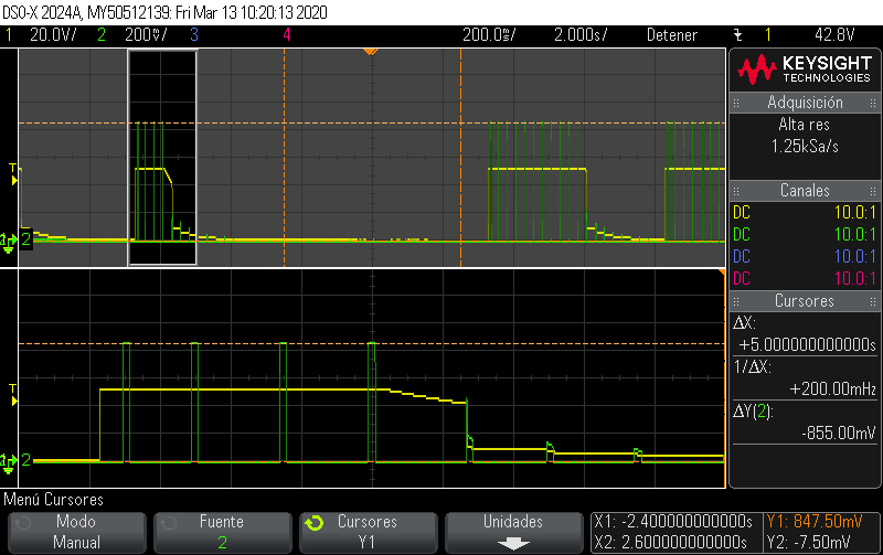

When I deactivated the “FET_EN” and trigger “CHG_FET_TOGGLE” and “DSG_FET_TOGGLE”, the CHG transistor is fixed ON (it’s ok) BUT the DSG transistor is activated BUT just a moment, in fact is activated and deactivated by itself in a loop. Please have a look to the picture. Is the DSG_EN signal from BQ7694000 to the BQ76200. The signal is ON/OFF every second more or less.

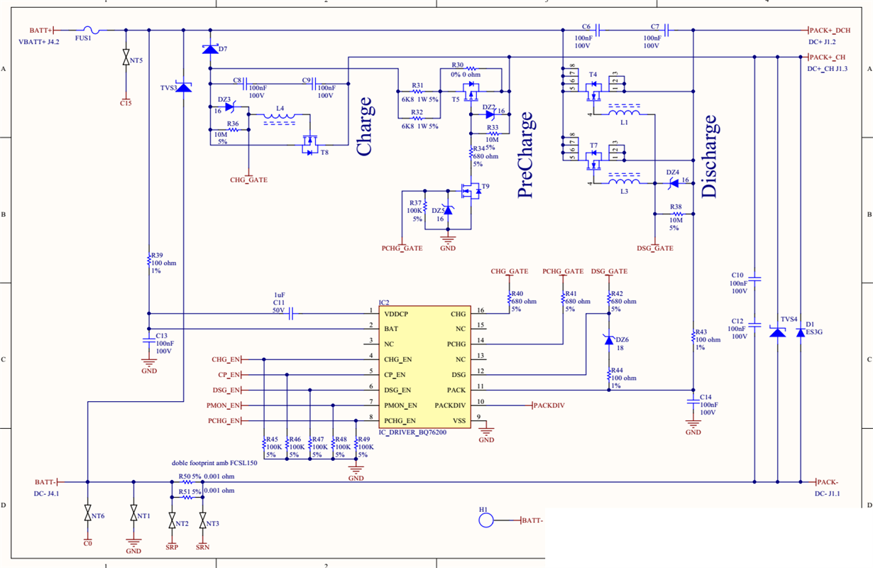

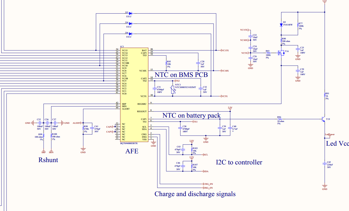

Attach some schematic as well.

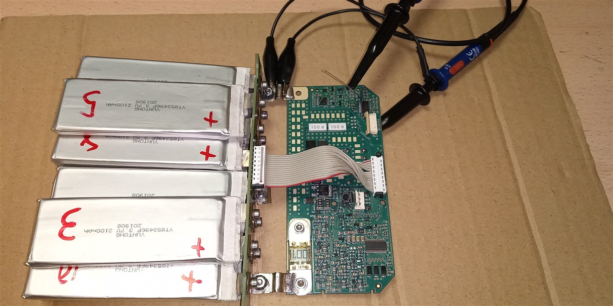

    hardware setup.jpg -> you can see the BMS and the batteries. Note that there is no power supply to charge; and there is no load discharge. So current=0A. The power contacts are on the bottom and they are not visible.

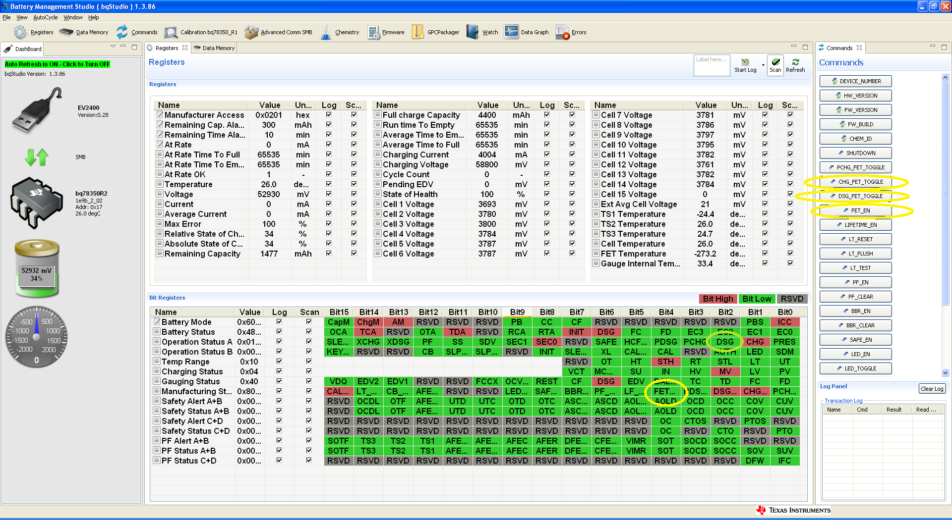

    Discharge voltage and alert signals.png --> You can see the voltatge on DSG path which is 50V but, as I told you, appear and disappear, I mean from 50 to 0. This is because the DSG signal from AFE is activated and deactivated by it self.  In addition you can see the alert signal from the AFE; note that is activated and synchronized when the 50V fall to 0V.
    BQStudio status.png--> Stattus reported by BQstudio.
    In my opinion, the AFE detects something wrong and activated the alert signal. Then the DSG FET is OFF and the voltage fall down. After some seconds recover and loop again.

  • Hi Albert,
    I see what you mean. It seems like there is a fault present that is causing the DSG FET to turn off. The BQ78350 is likely clearing the fault at the point where you see the activity and then the AFE is again detecting the fault condition.
    There are a few different fault condition on the AFE that can cause the DSG FET to turn off: UV, OCD, SCD, ALERT override, and AFE_XREADY. Some of these faults should also disable the CHG FET however. Table 1 in the BQ76940 datasheet shows the AFE responses to different fault conditions.

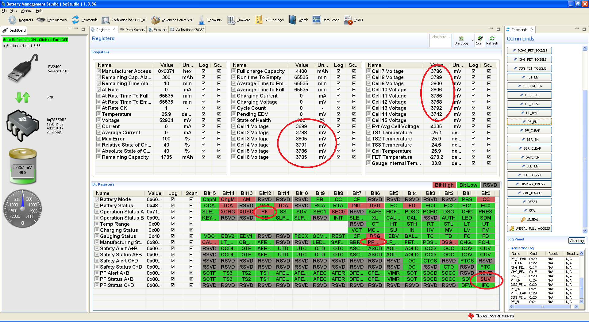

  • Hi Matt,
    You are right. I have to enable the PF via "PF_EN" button; and in this case the SUV flag is on. Safety under voltage.
    Note that I have available 14 cells, so the 15th is disable (short on VC15 to VC14 pins). I assume that there is no problem. I have updated the cell map, of course.
    BUT, have a look to the BQ studio print screen, the cell voltages are ok; so where the SUV comes from?

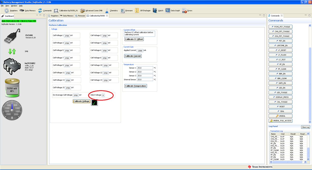

    On the other hand, the calibration, have a look the screen shoot, what I have to introduce on the Vaux paramater?
    Add a oscilloscope picture, where you can see the output voltage from 50 to 0 and the Vaux, which goes to 0,8V to 0

    sorry the picture attached.
  • Hi Albert,
    I believe the top cell must be connected for the BQ76940. There are tables in the BQ769x0 datasheet showing the cell connections for different cell counts. I think fixing this might resolve the SUV issue.
    Matt

  • Hi Albert,
    The top cell should be used or it can cause the SUV problem you are seeing. At first, it will operate normally with the top cell measuring 0V. However, as the system starts running, there will be transients as the thermistors are sampled every 2 seconds, so there will be a voltage measurement high enough to make the device think a cell is connected - eventually this can trigger an SUV. It is hard to see this by just observing the BQStudio main screen, but you might be able to see this if you collect log files with a fast enough sample frequency - you may be able to see the Cell 15 voltage jump up every 2 seconds.
    If you modify the cell connections per the datasheet recommendation, this issue should be resolved.
    Matt
