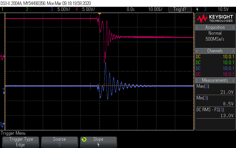

Looking at both IN and OUT pins waveforms during the short circuit, we see quite a bit of ringing. Only a device power cycle re-enables the output - EN pin toggle does not work after the output disconnect latch.
Can it be that after the short circuit and resulting voltage ringing the device enters some kind of latch-up and it's internal logic requires a power cycle? Can it be related to the internal UVP unit that samples the IN pin?
Adding input capacitance resolves this issue when input voltage ringing is reduced. I need to know if a device latch-up is possible due to input pin voltage ringing and that we really understand fixed the problem.
Some scope snapshots...
Input ringing with 0.1uF input cap (Blue Trace) and output ringing with 1uF output cap (Red Trace) - EN pin unresponsive, power cycle required:

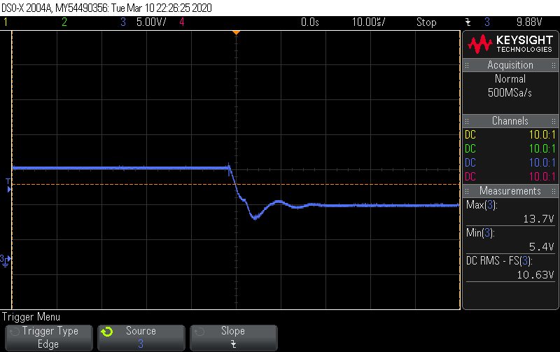

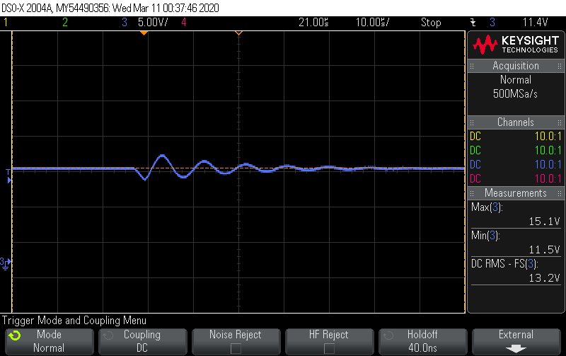

Input ringing with 20uF input cap and 10uF ouput cap - EN pin is responsive and re-enables the output properly:
Output with 10uF output cap & 20uF input caps - EN pin is responsive and re-enables the output properly:

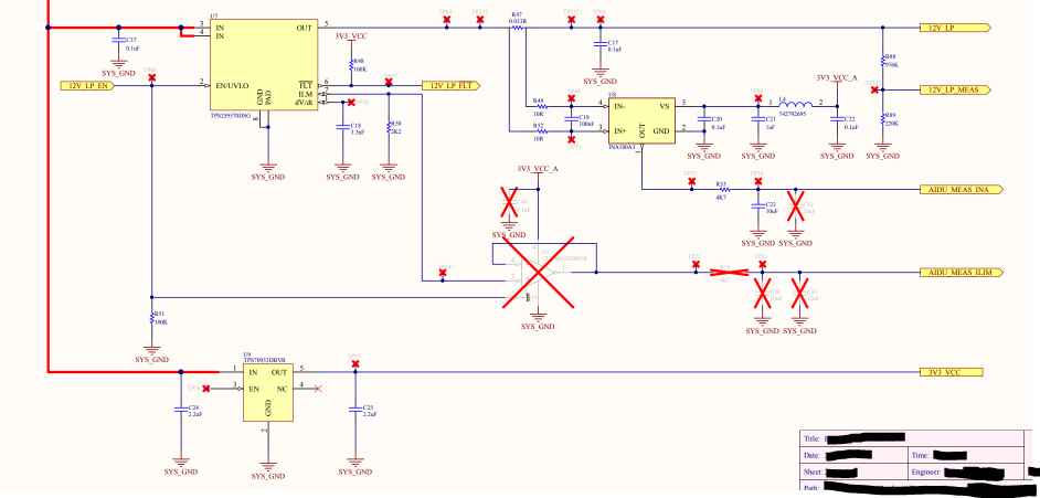

    Can you please share your schematics with us.
  • Hi Praveen,
    Thanks for your reply.
    Attached is a snapshot of the relevant schematics page.
    Thick red trace is a 12VDC power rail to the input of the eFuse and a small LDO.
    First scope snapshot from my original post was with C37,C17 & C24 as in the schematics.
    Second and third scope snapshot was after replacing these three capacitors to 10uF, 25V, X5R, 0603 MLCCs.
    After the capacitor change we could not recreate the problem and the device operates as expected.
    S.B.D
    Thanks for sharing the schematics.
    In your schematics, I don't see a TVS and Schottky diode which are placed at the input and output respectively to clamp for over voltages which can be generated during events like Fast trip /Short circuit because of the inductance present in the input and output path.
    Over voltages which are beyond the Absolute maximum ratings of the device can damage the device. In the wave forms shared by you, I can see that the input voltage max is 21V which is beyond the Abs Max rating of 20V. Please use a TVS like SMBA13A at the input. You can refer to the TPS2595 EVM schematics for more details.

    As you mentioned, we also noticed the over-voltage transient on the Vin pin and also the negative voltage transient on Vout before the capacitor swap.
    Could this lead to a logic latch-up event?
