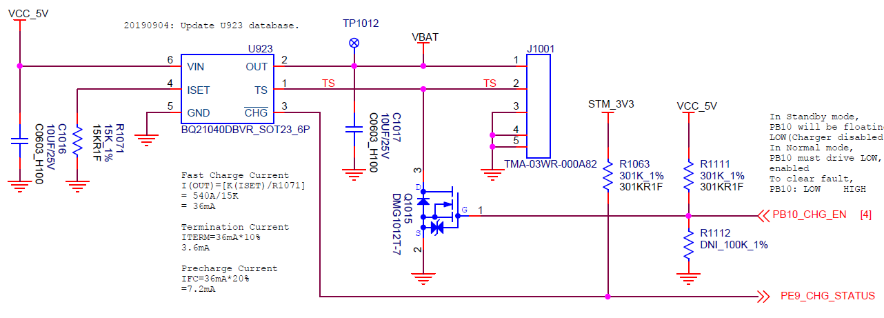

   BQ21040 TS pin is designed for use with a 10K NTC β = 3370, but my customer's battery NTC thermistor β = 3380. They want  to know:
   1. Will this β coefficient gap of 10 cause such a big error of high Temp? Or it doesn't matte and the circuits design is defective.
   2. If not, have any suggestion or work solution to using this NTC thermistor β = 3380
Note. Follows are the thermistor and circuit.
