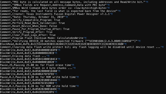

I know there is the "Firmware Upgrade Script" (csv file) that could be exported by the Fusion Digital Power Designer for UCD92XX devices. Then we can download the program flash and data flash () by a microcontroller or other "host" (an I2C master), called upgrade foirmware  "in the field".
But I could not find this function for UCD3138. Could it be for the UCD3138 devices?

    I'm not sure, but I think the CSV file is only for changing power supply settings, not the underlying program.  So it's really just a series of PMBus commands for things like filter coefficients and fault levels and gains and offsets.

    Attached the csv example:
  • As I thought, the CSV is only a file for updating the parameters, not the firmware.
    It is probably possible to do the firmware upgrade with a very long series of PMBus commands only sent, but that is not how we generally do it.
    We do several verification steps which require the master to receive and evaluate data from the UCD.
    1. Verify the ROM version to make sure the chip is correct and in ROM mode, ready to recieve
    2. After the download, but before writing the checksum - have the ROM calculate the checksum from the UCD program flash and make sure it is the same as our calculated checksum - this verifies that the download is successful
    3.  Do the same for the data flash.
    There are other checks that can be done that are optional.  Right now we do not have a function to generate a .csv file.
    Since the data is just a big memory image, the normal way our customers do the download is to write a program for the master that takes a object code file, either binary or some hex format, and generates the commands to download and verify.
    I can send you a document on the sequence of commands.
