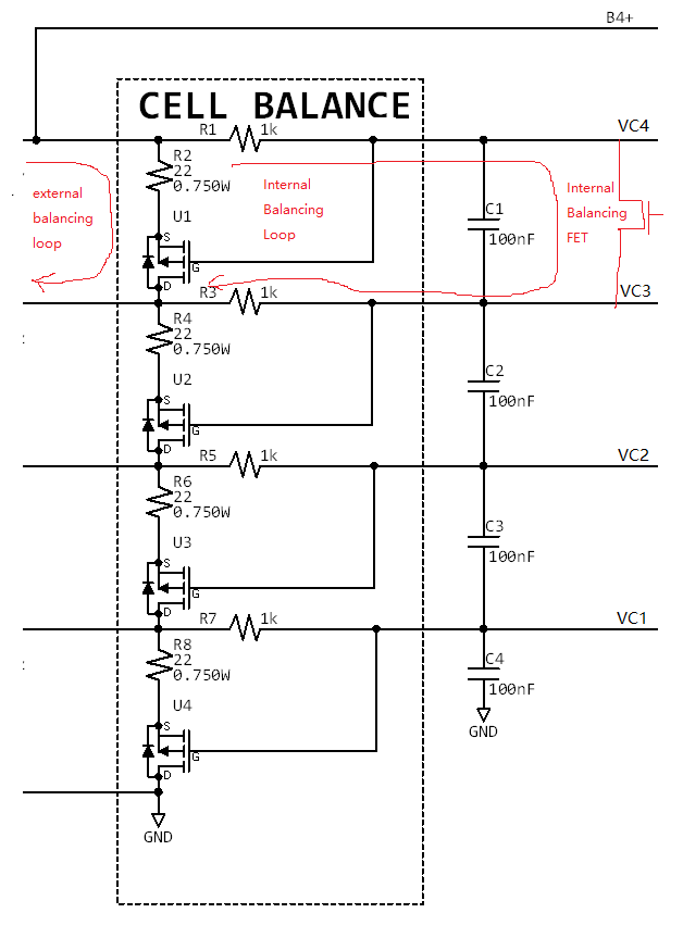

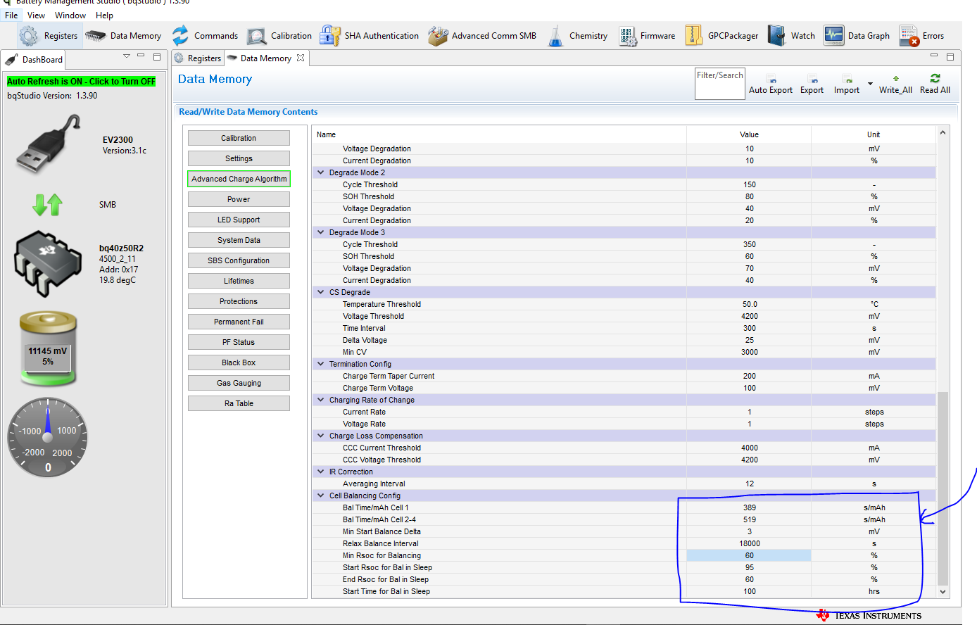

I want to ask some question about Internal Cell Balancing problems.

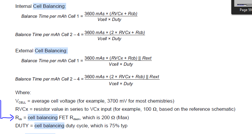

Is there any something wrong with calculation or the settings ? I use Lithium Polymer Battery 3S Configuration and have already calculated the cell balancing time based on commands manual.
Here i attach file gg.csv file in ZIP format
