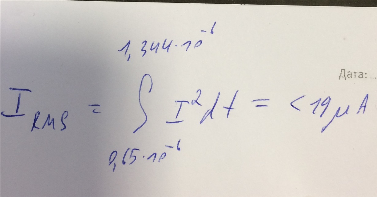

And additional, I`d ask how did to find RMS ripple current in 143 mA?

for RMS ripple current, you need calculated the duty cycle first, then you know the raise time and fall time of inductor which means you have I(t) function. then integrate I(t)^2 from 0-ton and ton-toff, then you can have Irms at 140mA

In my solve, I got ton=0.65*10-6 c and toff=1.344*10-6 c. Is it can be true? In finally I got 19 uA current ripple.

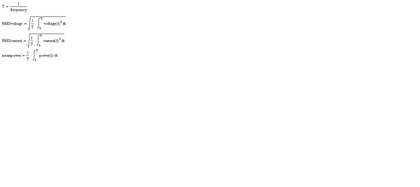

Hi, Daniel! I used the RMS current formula and fugure out not the same result as program`s TI. My value is 0.6 uA ! Instead zero I put the number is 0.65*10^-6 and instead T - 1.34*10^-6. Then first I calculated not-defined integral: 1/3*(Output current^3, where Output current = 3A). In the end I calculated defined integral.
Maybe I catch a mistake?
Hi
t is time, inductor current is function with time, no t , how you can get the integration result by dt, it will be a constant value?
I think your question is not related to our product spec or application, pls figure out how the RMS been defined by yourself. then you can know this formula meaning. and you also need to know the inductor waveform based on the software and apps notes I send to you.
