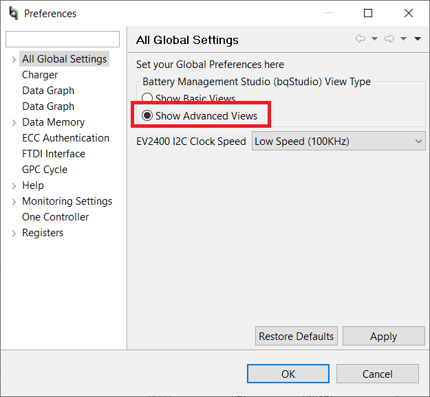

Hi all. I have a question about the dataflash table.  The reference manual is not that very clear about which addresses are filled in by the BQ34110 and which should be set by the user.
We are in the process of programming the dataflash of the BQ34110 in our embedded system by making use of the micro controller we use.
We have come pretty far so far but some addresses refuse to be programmed and we found some mentioning of read only addresses here and there in the reference manual.
Is there a list which addresses are read only and which addresses are allowed to be written and read from ?
Also, we have encountered on two different pc hardware configurations that the BQstudio 1.3.86 sometimes refuses to send messages. We checked with the logic analyzer on the i2c pins of the EV2400 module.
Nothing is there and that correlates with the BQ34110 not doing what we expect.
windows 10 pro 1909 . OS build 18363.657.
So now we are in the process of understanding how the device works and programming the device ourselves.
Later on we are going to fine tune the device when the issue with bqstudio is silved.
