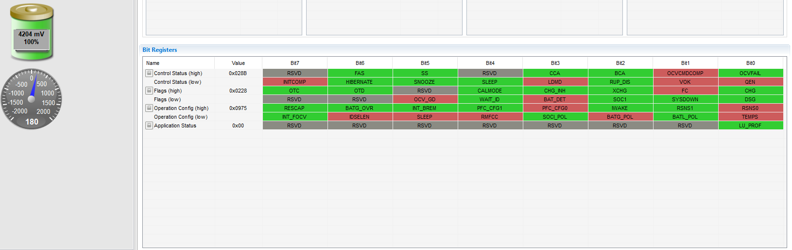

    Charge current is 180mA as reported by BQ27510-G3 (Should be terminate by now 256mA +/-20% = 204.8mA)
