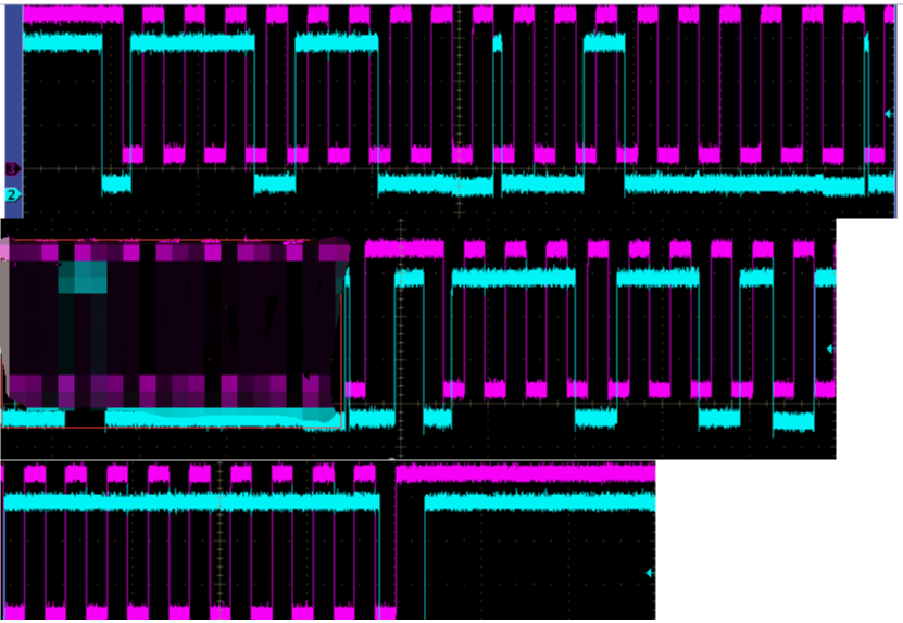

    Thanks for your response. Below pictures is the CLK and DIO data of read command code 10h, the three picture combined together is a full cycle.
    For the address of PMBus set to 0x76, and the external pinstrap setting as below picture.
    Thanks.
    Sammi

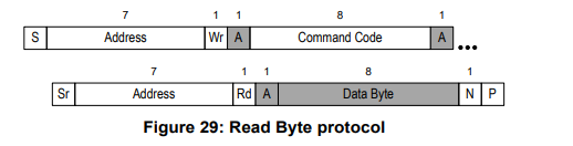

  • Hi Sammie, based on my decoding, the transaction structure looks incorrect. Can you please double check it?
    I see:
    <Start><Slave Address + W><Ack><Command code 0x20><Ack><Command code 0x20><Ack><Repeated start><Slave Address><....>
    Should be :
    <Start><Slave Address + W><Ack><Command Code 0x10><Ack><Slave Address + R><Data><Nack><Stop>

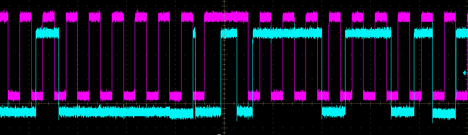

    Thanks. Checked with customer and update the new waveforms:
    Customer also checked the frequency of clock only 2.6K, any special requirement of clock frequency?
    Thanks.
    Sammi
  • Hi Sammi,
    I am assuming the pixelated portion of the waveform is just repeated from the top waveform? Assuming that is correct, I think the structure looks OK:
    <Start><Address 0x76 + W><Ack><Cmd code 0x20><Ack><Repeated Start><Address 0x76 + R><0xFF><Nack><Stop>
    It is interesting the device appears to ACK the final data byte and still respond with 0xFF
    Is it possible to try this with the TI GUI USB-to-GPIO and Fusion Digital Power Designer. ? Can you also scan the bus to see if the device is responding to the expected address?
