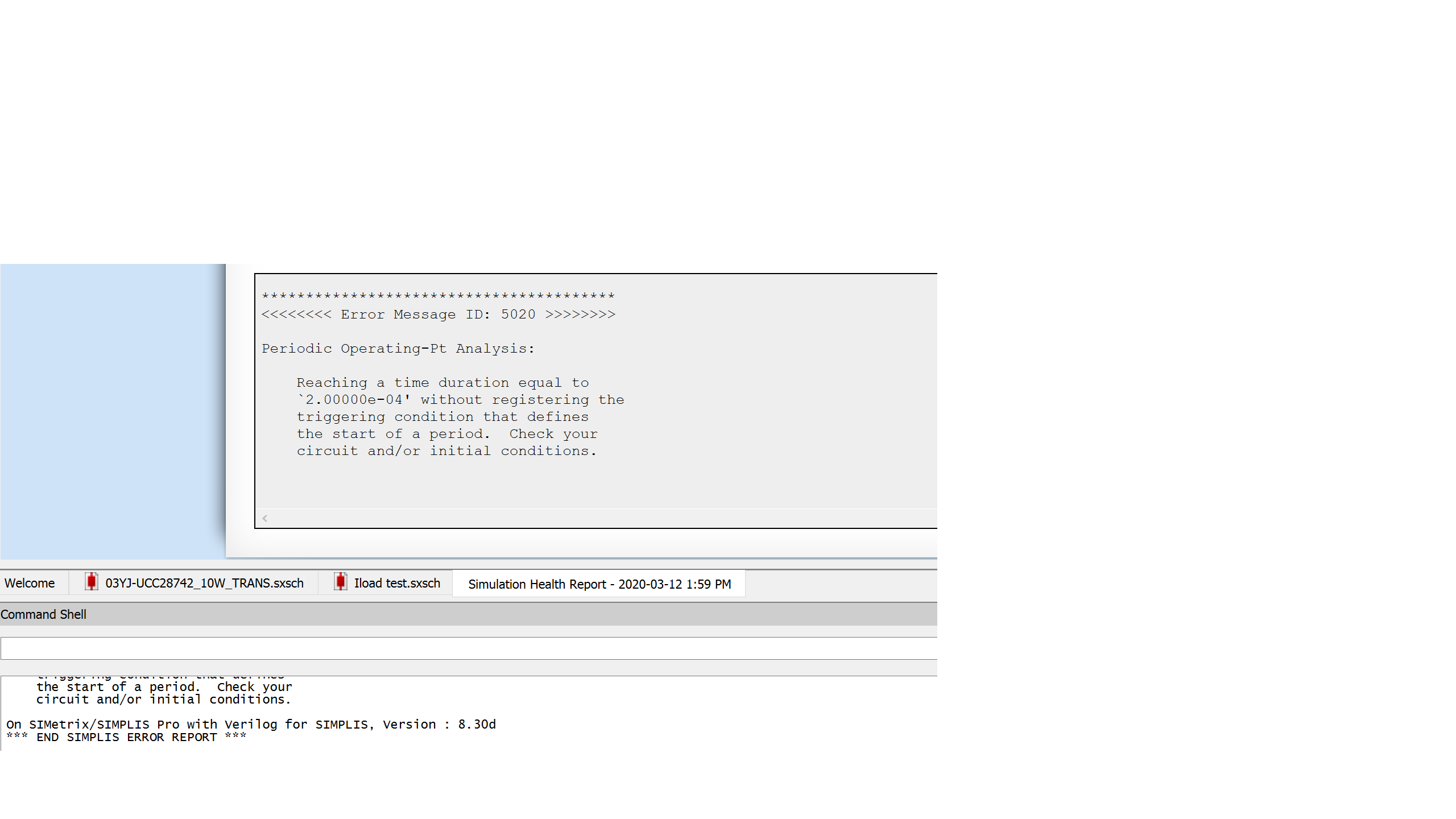

I am using UCC28742 simplis model that is shown in ti.com/UCC28742 product page. But I meet two issues:
1. I cannot run POP or AC analysis with your example, the error report is shown in below picture, and you can reoccur this issue with the example model. How can I fix it?
2. This example is designed for 85V~265V input, right? But I cannot start up the converter at 85V input.  You can reoccur the waveform of 85V input, the circuit I use is TI example circuit. How can I fix it?

  • Hello Rachel,
    Thank you for your interest in the UCC28742 flyback controller.
    I ran the simulation and got the same result as you did. I tried different POP settings but still got similar errors.  Since this controller operates with valley-switching and frequency dithering (for EMI reduction), I believe that there simply is no periodic operating point that can be found.  The cycle-by-cycle switching variations are too much for the POP, no matter how insignificant they appear visually.
    The help file from Simplis states that the POP analysis looks for convergence of repeating states to within very tight accuracy.  Even though this part obviously works well for regulation, I think this device simply does not repeat the cycles with enough consistency to satisfy the POP analysis.
    I don’t think there is any way to fix it.
