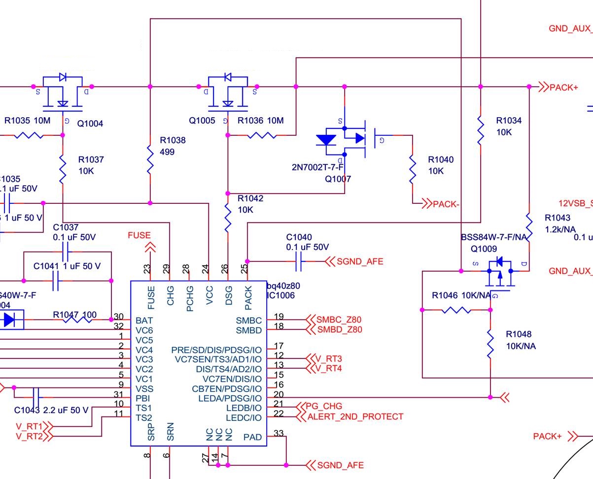

Hi Sir,

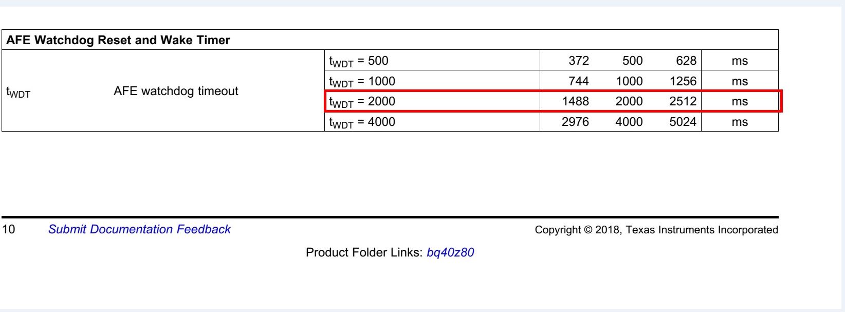

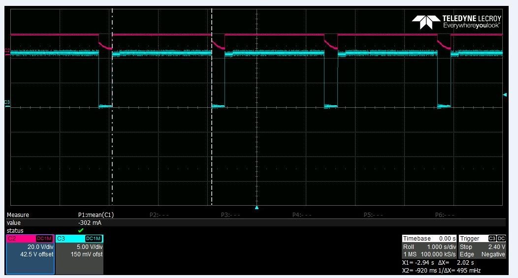

We met DFET will ON-OF-ON-OFF when bq40z80  battery voltage too LOW. and we confirm is trigger by AFE watchdog timeout.
May I know if AFE watchdog relative with input voltage of pack pin?
Can I say if increase battery voltage will avoid the issue?
