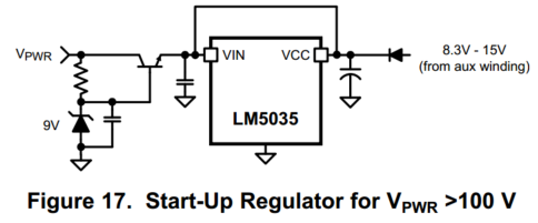

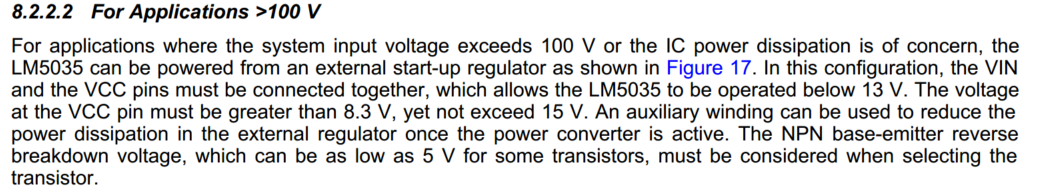

Hi team,
I am wondering if LM5035 can be used when Vin is higher than 105V. If yes, how do you deal with Ramp, Vin and Vcc pin?
Yangbo
