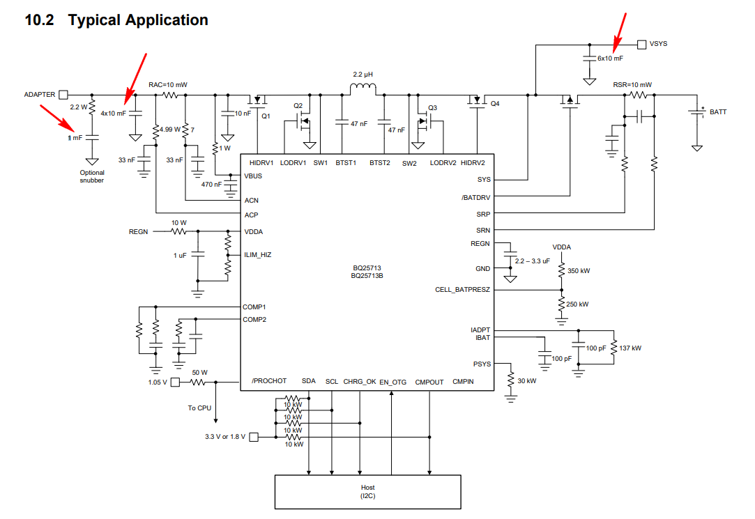

My customer is using BQ25713 as solution , and they are refering the d/s schematic and found a question,
is below red mark cap value have typo? the capacitance unit should be uF not mF.

Hey Andy,
That is correct. This is a typo.
You can refer to the full schematic checklist guide line here for further information on the BQ25713 required components:
