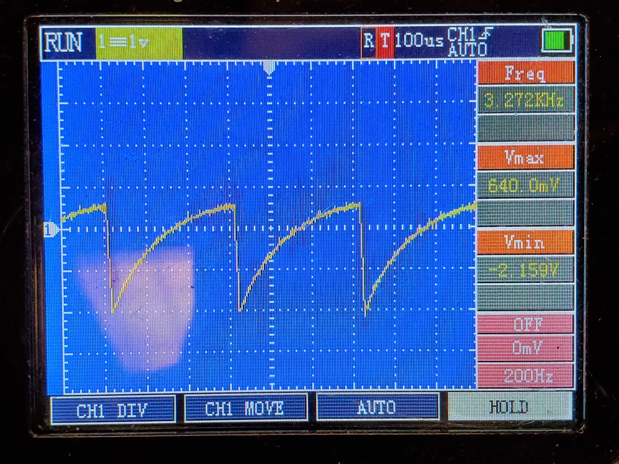

Ive configured the charge pump as per the typical application on page 11 of the datasheet, but for some reason I haven't figured out yet there's a high chance upon power up the output voltage is a very consistent wave from 0.6V down to -2.2V (image from scope below) But this is not always the case. If i simply unplug power from the device and plug it back in whenever the output is resonating the charge pump will eventually give me the -5V i'm expecting, occasionally when i connect power and the voltage is oscillating it may rectify itself after a second or two, but if it doesn't correct itself after a couple seconds it wont ever get to -5V

    I'm supplying the device with 4.9V, and expecting it to output roughly -4.9V, instead when i power it up the device usually gives me a ~sawtooth output bouncing between 0.6 and -2.2V.  power cycling the device will eventually get it to output -4.9 but i need it to output th e-4.9 every time.

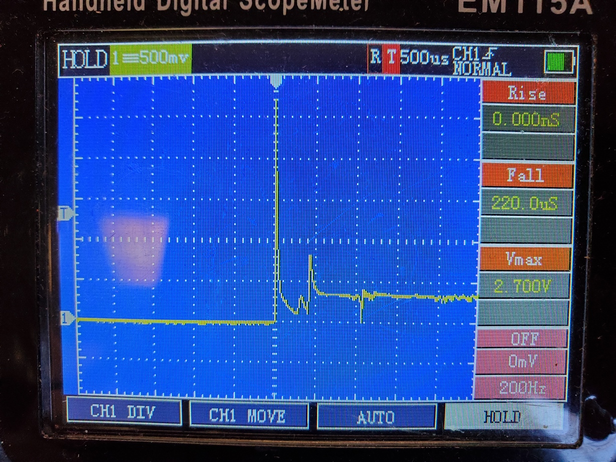

  • Using a 4ohm resistor in series with the 5V power supply i pulled this curve during power connection, the peak equates to 675mA of inrush current, most of that is likely due to the 42uF of capacitors on the board. resting current draw with only the 68ohm resistor loading the charge pump is roughly 75mA. This graph was taken from a successful startup of the charge pump.
    Here's the interesting part: the pump fails to work whenever powered by the 5v supply on my usb powered arduino due, but it works perfectly once a 4ohm resistor is in series with its 5v supply. If I start the pump with a normal 5v wire coming from an arduino mega powered by usb it works almost always, if i start the pump with a normal 5v wire coming from an arduino due it fails almost always, if i then connect a 4ohm resistor between 5v and the charge pump the pump continues to provide incorrect output, as soon as i then remove the 5v wire from the pump(thus leaving just the 4ohm resistor supplying the pump) the output immediately corrects, i can then connect the normal 5v to the pump and remove the resistor and the output continues to stay at -4.9v.
    due to that strange behavior i'm unable to get a powerup current curve for when it fails to start.
    It seems the inrush current is too high for the device to startup. the datasheet doesn't specify a over current shutdown, only that the device will limit current draw and likely thermal cycle when >400mA is drawn from the input. I'm doubting that it's internals are thermal cycling at 3.2khz leading to the incorrect output. while 675>400 i would expect it to take longer than 50 microseconds for the device to overheat and shutdown from this current draw.
