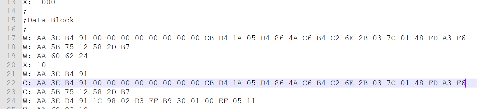

We're working on a product using the BQ27220 fuel gauge from TI, with the host being an ST processor (STM32F429AI). The communication interface is I2C, running at the standard speed of 100kHz. We have separately ordered the eval kits EV2400 and BQ27220EVM-744. I've used bqStudio in combination with these boards in order to generate a FlashStream file for our application. I've implemented the gauge.c/gauge.h files detailed in the Appendix of TI's document Gauge Communication (SLUA801). I have fairly high confidence in the implementations of the read/write functions as we are able to get through the beginning of the FlashStream file just fine (refer to slide 4 of deck below). The failure in the FlashStream loading occurs when we write to the data memory and attempt a read back -- the data written and read back do not match, causing the function gauge_execute_fs() to return prematurely.
Here are the links to (1) a Google Slide deck and (2) the FlashStream file generated:
I've tried different combinations of sealed/unsealed/config mode etc. but still unable to get the file to load successfully. Would appreciate any input from the community.
Vignesh

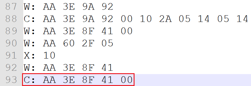

  • Hi Vignesh,
    I had a chance to verify the gm.fs file.  I see that my FlashStream tool also fails.  The failure occur to Line 93, which is highlighed below.
    Can you follow the steps below and test your gm.fs file again?
    a) Use the bqStudio to put the bq27220 into the FULL ACCESS mode.
    b) Download the gm.fs file and see if Line 93 also fails.
    Andy

  • Hi Vignesh,
    Yes. I can see the same failure when my tool is performing the first "compare" instruction (Line 22), if I don't put the bq27220 into the FULL ACCESS mode first.
    The bq27220 device on my EVM is in the UNSEAL mode after power-on.  I can see the failure occurs much later (still Line 93) if I comment on the following two lines.
    ;W: AA 00 14 04
    ;W: AA 00 72 36
    I suggest you double check.
    Andy

  • Hi Vignesh,
    Yes.  It seems like it is necessary to comment out these two lines if the gauge device is already in the UNSEAL mode.
    Andy

    I had a chance to test out your suggestion to comment out the two lines pertaining to unsealing the device, but did not notice a difference in which line the file loading failed. It still only got up to line 23. For your reference, I've attached the following files:
    test1.fs.txt: original FlashStream file from this post (renamed to .txt extension)
    test2.fs.txt: FlashStream file with lines 9 and 10 (device unsealing) commented (renamed to .txt extension)
    test1_fs_log.txt: Debug log output when calling the gauge_execute_fs() function with test1.fs as the parameter.
    test2_fs_log.txt: Debug log output when calling the gauge_execute_fs() function with test2.fs as the parameter.
    I'm attaching the debug log output files so you can double check that the I2C transactions are happening correctly. Every byte sent and received is printed out there.
    Currently, the host processor simply boots up and initializes its I2C bus before calling the gauge_execute_fs() function. This is similar to the example in Appendix A of the Gauge Communications document.
    Please advise on how to proceed. Thank you!
    Vignesh

    Gauge address set to: 0xAA
    Writing to reg addr=0x5B
             [00] 0x75
             [01] 0x12
             [02] 0x58
             [03] 0x2D
             [04] 0xB7
    Writing to reg addr=0x60
             [00] 0x62
             [01] 0x24
    Delay 10000us
    Writing to reg addr=0x3E
             [00] 0xB4
             [01] 0x91
    Reading from reg addr=0x3E
    Comparing data of length=29
             [00] 0xB4 -- 0xB4
             [01] 0x91 -- 0x91
             [02] 0x00 -- 0x02
             [03] 0x00 -- 0x20
             [04] 0x00 -- 0x00
             [05] 0x00 -- 0x03
             [06] 0x00 -- 0x00
             [07] 0x00 -- 0x00
             [08] 0x00 -- 0x00
             [09] 0x00 -- 0x00
             [10] 0xCB -- 0x00
             [11] 0xD4 -- 0x00
             [12] 0x1A -- 0x00
             [13] 0x05 -- 0x00
             [14] 0xD4 -- 0x03
             [15] 0x86 -- 0x00
             [16] 0x4A -- 0x00
             [17] 0xC6 -- 0x00
             [18] 0xB4 -- 0x00
             [19] 0xC2 -- 0x00
             [20] 0x6E -- 0x03
             [21] 0x2B -- 0x00
             [22] 0x03 -- 0x00
             [23] 0x7C -- 0x00
             [24] 0x01 -- 0x00
             [25] 0x48 -- 0x00
             [26] 0xFD -- 0x00
             [27] 0xA3 -- 0x00
             [28] 0xF6 -- 0x00
    fs_ret =
    C:AA5B7512582DB7

  • Try this gm.fs below.  I only changed the Full Charge Capacity and Design Capacity and all the other settings are default.
    I can program it without any problem.
    Please follow the steps below.
    a) Use a bq27220 EVM and put the gauge device into FULL ACCESS mode with the bqStudio .
    b) Program the gm.fs file. You are supposed to see zero failure.
    c) Launch the bqStudio again and you will see the Full Charge Capacity and Design Capacity are updated to 4000mAh.
    https://e2e.ti.com/cfs-file/__key/communityserver-discussions-components-files/196/bq27220_5F00_4000.gm.fs
    If you fail to download that gm.fs file, there should be something wrong with your firmware code.  I am using the same code from the app note SLUA801.
    Andy
  • Hi Andy,
    Thank you so much for sharing the file which you validated as working.
    Some good news - I was able to figure out the issue thanks to the alternative gm.fs file you sent. When I tried to load it and compared the debug logs between your file and my previous file, I noticed that there may be a potential timeout issue with the I2C reads. As I debugged the code, I noticed that I2C reads from standard command registers worked fine, but just before the FlashStream file loading failure, the I2C reads from the data memory would time out waiting for an ACK from the bq27220. I had to increase the delay here in order to allow it to be read properly.
    The previous file which I sent over originally (test1.fs) now gets loaded in its entirety without issue. I have verified this by printing out the design capacity before (3000mAh) and after (1300mAh) to verify that this parameter is loaded correctly.
    However, the new file which you sent over still fails. The failure happens around line 83:
    The gm.fs file expects to read 0xA6 there, but the host processor reads 0x00. I have not dug into this further but just wanted to point it out.
    Just a few final questions:
    1. Is there some spec in the datasheet/TRM which I may have missed specifying what the read latency should be when reading from the data memory as opposed to reading from the standard command registers?
    2. In your experience, what is the time it typically takes to fully load a gm.fs file onto the BQ27220 over I2C at standard speeds (100kHz, 400kHz)?
    3. It is my understanding that these values are stored in the fuel gauge's volatile memory, which is lost when the battery is physically disconnected (regardless of whether the device itself is on or off). Is it recommended to load the gm.fs file every time the product boots up, or is there some way we can read the fuel gauge status registers and only load the gm.fs file if we find that the file has not been previously loaded?
    Thanks again for your help and patience!
  • See my quick comments below.
    a) I'm using 100kHz I2C in my code.
    b) I add a 1 ms delay after each i2c read or write operation in the function gauge_read() and gauge_write().
    Andy
  • Andy,
    Thanks for sharing your code snippets, that is certainly helpful. I'd just like to repost my final outstanding questions to help better understand in-field usage:
    2. In your experience, what is the time it typically takes to fully load a gm.fs file onto the BQ27220 over I2C at standard speeds (100kHz, 400kHz)? Through a quick measurement, it took me about 9s to load a gm.fs file at 100kHz. Is this on the order of magnitude of what you would expect? I'd like to make sure we don't have any unnecessary delays as boot up time is something we are trying to keep to a minimum.
  • See my comments below.
    [Andy] I guess what you should be aware of is the 66us waiting time between all packets. I use a 1ms delay between each i2 writes in my code.
    [Andy] It takes my tool around 0.8s to download gm.fs at 100kHz, if the 5 lines below that are used to unseal devices are commented out.
    ;Unseal device
    W: AA 00 14 04
    W: AA 00 72 36
    W: AA 00 FF FF
    W: AA 00 FF FF
    X: 1000
    [Andy] We suggest customers use the gm.fs file to program the bq27220 every time the gauge is reset or powered up.
    Andy
