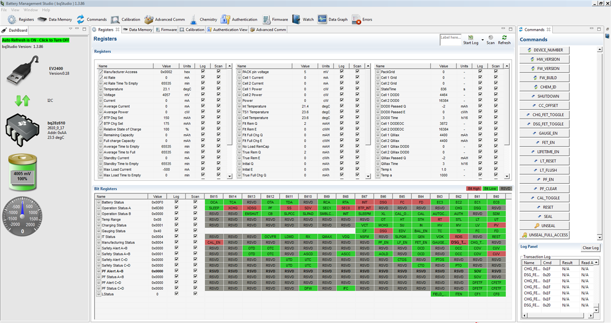

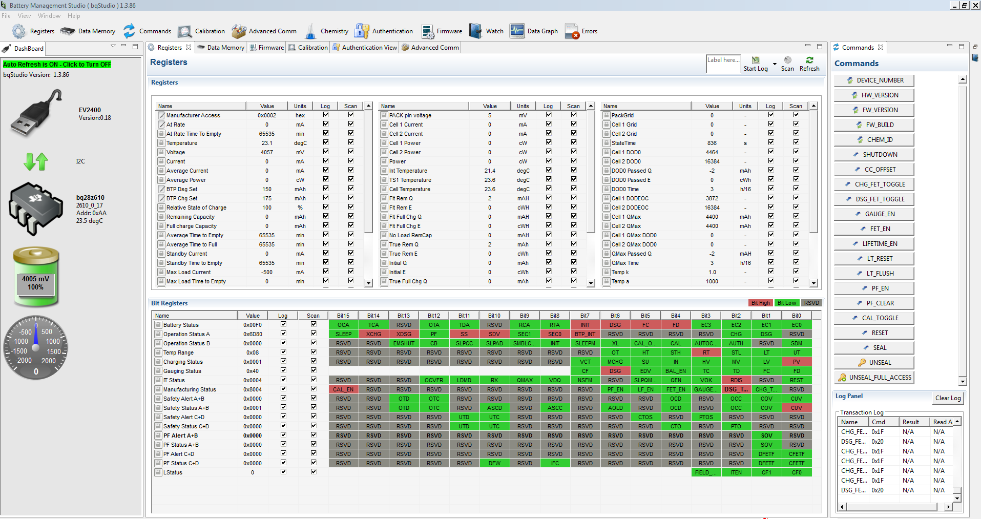

Hi all,
I am using the BQ28Z610EVM-532 with bqstudio to do a charge-discharge cycle for GPC tool. Everything was working fine until after I left the batteries relax overnight, now I cannot toggle the DSG and CHG FET (I checked and the voltage at the DSG and CHG pins are 0 the whole time, but I can still see the chip on bqstudio dashboard). I notice that if I use 2 batteries in series then it works again. Does anyone have any idea what causes the problem?
Also another question not related to this: In the EVM, I supposed to press the button to wake up the chip (although most of the time if I connect a load to PACK+ and PACK-, it will draw enough current that drops the voltage of PACK pin so low and the chip cannot be woken up). How can I wake up the chip in custom application? I don't see any switch in the suggested application in the BQ28z610 datasheet.
