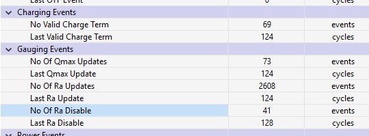

What conditions disable Ra update? What happens when Ra update is disabled? How does it impact battery?
I also notice a few of ASCC events in LifeTime log. How does this impact?
See 6.4.6 Ra Table Update Conditions for the details. It might impact the RSOC accuracy.
I would suggest you run a charge-discharge cycle and check the RSOC accuracy.
