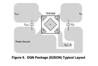

TPS7A20: Chip packaging problem
Part Number: TPS7A20
Other Parts Discussed in Thread: TLV9061,
hi
I compared the X2SON package of the TLV9061 and TPS7A20 chips. They have different package pin numbers.But what makes me even more surprised is that the TPS7A20 gives a "Bottom View", and the TLV9061 gives a "Top View". It is difficult for me to judge whether the TPS7A20 package drawing and the perspective direction are correct. Isn't it for "Top View" in general?Please help determine
