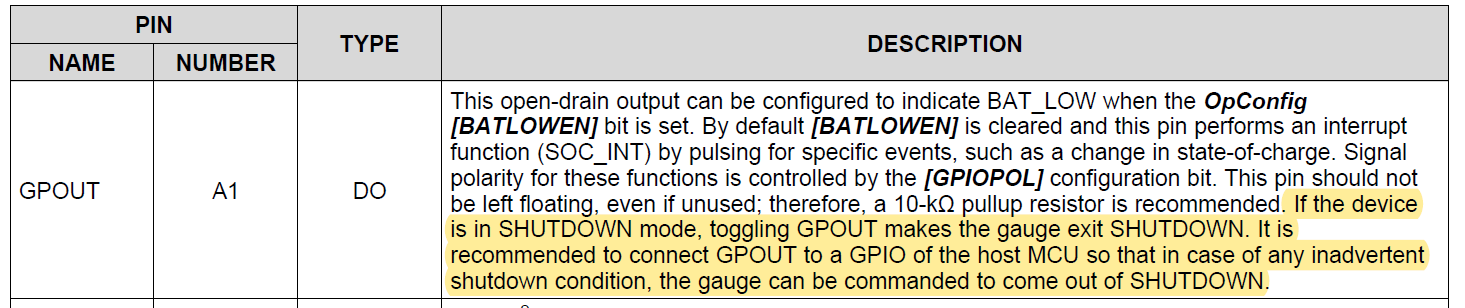

(1) Could you provide functionality of GPOUT?
    See the details in the datasheet and TRM.

    For question (1), customer is bit confused by the comment in Figure.2, "GPOUT is configured as and input for wakeup signalling".
    Does this mean GPOUT is used as wake-up state flag for MCU which is connected this signal?

    a) See the description in the datasheet.
