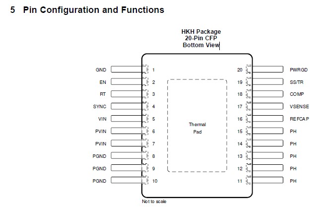

Is the pin configuration information in the datasheet below correct?
Is Bottom view right?
Best Regards.
    Bottom view is NOT correct!  This is obviously the top view.  The package drawing at the end of the datasheet shows the bottom view.  Thanks for pointing out this error.  I make a note to have this corrected in our datasheet.
