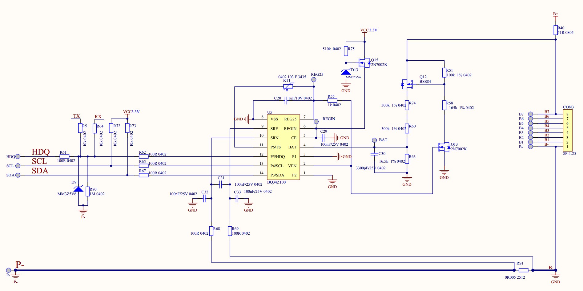

BQ34Z100: First use BQ34Z100, Please help to review the schematic.
Part Number: BQ34Z100
This is my first design of BQ34Z100,  7S cells and HDQ communication need.  My first question is can this device support I2C and HDQ interface at the same time?
In my case, I need to use both of these interface.
Also Please kindly help to review this design.
Some differences compared with ref design are as below:
  1. Shunt resistor : used 5mΩ  instead of 10mΩ,due to bigger current .
  2. Used  R40 at BAT+ to limit the current .
  3. Used two 300K resistor, R74,R60, according to datasheet, but not sure if it is suitable.
