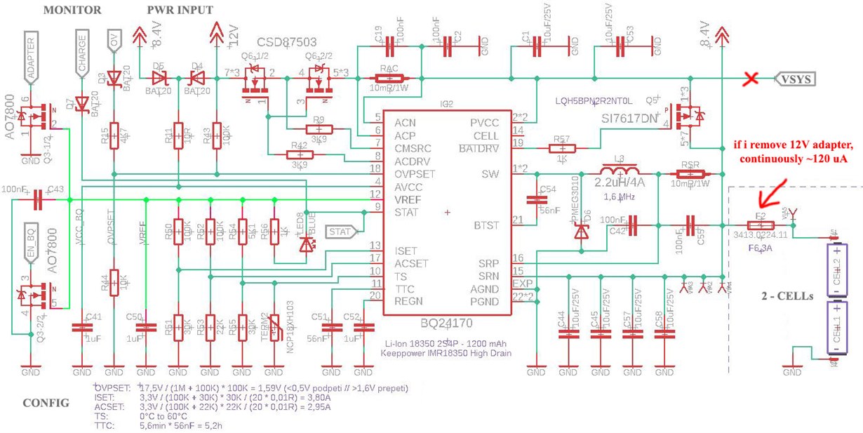

I would like you to ask about specifics information. In my design I am using BQ24170 device. If I´ll remove 12 V adapter, the device fall asleep (Vref signal fall down - everything is OK).. but current from battery is still larger then 100 uA (typicaly 120 - 170 uA). How is it posible? Could someone please measure this circuit please? Datasheet describes about 15 uA

    Do you have any load on VSYS?
    If you remove Q5, does the current reduce?

    The 15 uA leakage is measured on a tester with no active components connected to the IC. As such, I would look at the active component leakage currents in your circuits, such as diode reverse current.
    I would also recommend checking the ACDRV voltage. If it is not close to 0 V, you may need a 500 kOhm resistor from ACDRV to CSMRC to drain the charge pump. This is recommended in the datasheet.

    1. No, I don't have any load on VSYS (Q3 is removed too)
    2. If I remove Q5 the current is still the same
    3. I know that each active components consumes some (leakage) current, but more than 100 uA is too much for my circuit. I need total current less then 30 uA
    4. I added 500 kOhm resistor from ACDRV to CSMRC - now voltage on ACDRV to CSMRC is 1.8mV
    For measure I use UT61E multimeter
    PCB is clear from a flux and a impurities
    Every components are as close as possible
    Could someone please measure this circuit? ..or the bq24170EVM Evaluation Module

    I measured on the EVM and concluded that the battery discharge current into the IC was less than 13 uA. I think there is another leakage path somewhere.
