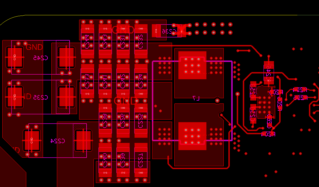

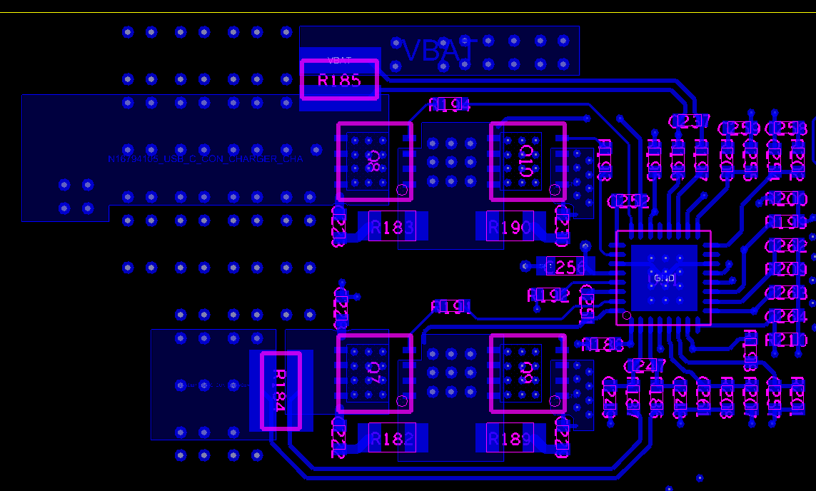

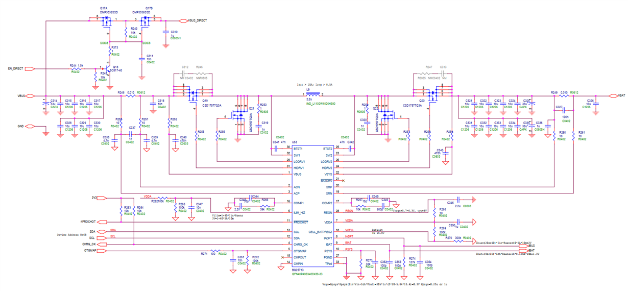

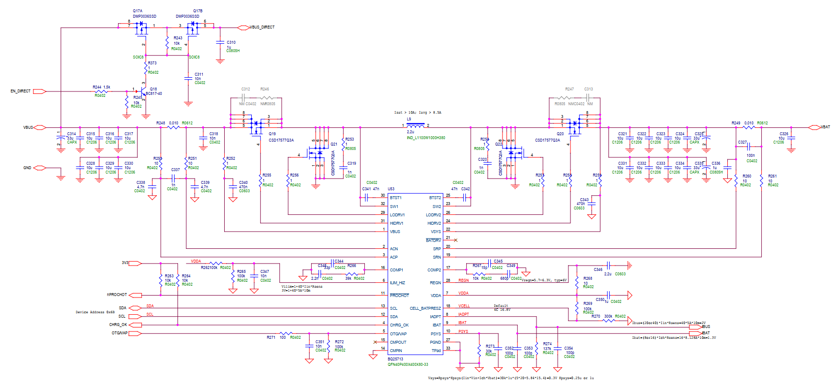

    Please look into SCH and layout. We have 8 Layer PCB and enough copper close to mosfets. 4 internal layers are filled with copper (2 GND shapes, 2x power shapes)

    Looking at your schematic, you added 1-Ohm resistors to the gate drive signals, which will increase your switching loss by slowing down the rise time and fall times of the FETs. I would start with reducing this to 0-Ohms. This will provide some marginal improvement. I would also depopulate the RC snubbers you have added on SW1 and SW2 because these will have the same impact.
    However, I would also mention that because you are primarily operating in forward boost mode, HSFET1 is ON a majority of the time, so it assumes the full inductor RMS current while HSFET2 and LSFET2 are switching. So selecting a HSFET with much lower RDSon will help reduce it's power dissipation significantly. Assuming you have 11.2V input @ 100W output w/97% efficiency, that is about 9A of current through the 5mOhm CSD FET you have, which equates to ~400mW power loss (about 13% of your total power loss). If you select a MOSFET with half of that, or add a parallel FET to drop this in half, it will cut your power loss by 200mW.
    Same comment as above for the switching FETs. Reduce the RDSon as much as you can.I would also look into the reducing the inductor DCR as much as possible. I don't have information on your inductor, so I would suggest.

    As far as the layout, for one, the component designators on the layout do not match your scheamtic designators. But imagine you have the inductor on the top layer and the MOSFETs on the bottom layer. I would suggest pushing the MOSFETs further away from each other. And you may even more the inductor further to the left in order to avoid it heating the area underneath it directly, which is indirectly where the power MOSFETs are sitting.
    Keep in mind that this is mostly intuition and best guessing when it comes to optimizing the layout for better thermal performance. Unfortunately, it is very difficult to both model and simulate every possible version of component placement, PCB copper thickness, layer stackup, etc. and find the optimal layout. So I highly suggest starting with the direct power loss factors, namely the inductor and the power MOSFETs.
