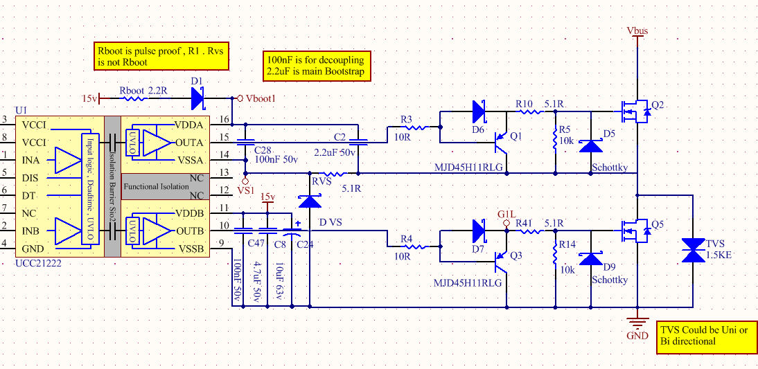

  • Dear John
    Thank u , the answer you provided was perfect .
    I do have a follow up regarding your suggestions on how to mitigate the ringing.
    According to Fairchild Ap Note: AN-6067 "Design and Application Guide of Bootstrap Circuit for High-Voltage Gate-Drive IC"
    It suggest to use a Resistor between HS pin and Switch node and use a schottky diode between Hs and Com to prevent overcharge of the C boot.
    I updated my schematic that is based on Ti TIDA-00364 : "48-VDC Battery Powered Inverter Power Stage Reference Design for 5-kW Forklift AC Traction Motor"
    note: the schematic is showing 1 mosfet per leg , but in other variants there is up to 3 mosfet per leg. Also I will be moving to SMD mosfet to improve layout. Snubbers will not be used since they are making the ringing worse at different output currents ( load )
    please feel free to comment on the circuit.
    1. Does Rvs and Dvs help in making circuit more robust ?
    2. Does the TVS help ? does it have to be unidirectional ?
    3. Any other component to add to make the circuit more robust ?
  • Hi Sammy,
    I do not commonly see this technique used, but it should definitely help the bootstrap overcharge challenge. I should point out that C2 is tied to the right side of RVS which defeats the purpose of having RVS there. DVS does add some additional capacitance to the switch node as well, so it is important to consider the tradeoff between that and a different type of clamping circuit. RVS also adds additional resistance to the gate driver turn-on loop, which will potentially increase turn-on time and switching losses.
    1. RVS and DVS will probably make the circuit more robust, but they do have tradeoffs which may slightly decrease performance. This is probably worthwhile for the benefit of the system, though.
    2. I’m honestly not sure on the TVS diodes being beneficial or not since I don’t typically see them used. I would typically see an external Schottky diode to help shunt current away from the body diode of the FET while it is freewheeling. If you are using the same 100V FETs from the TIDA-00364 reference design, then they should be robust enough to handle overshoot/undershoot in a 48V system without the TVS.
    3. I might suggest adding an additional 0 Ohm resistor at the gate of the FET in case a ferrite bead needs to be added. Ferrite beads are typically useful for reducing gate ringing while hard switching at high load if necessary. I would also make sure that Vbus is adequately decoupled with the proper mix of bulk capacitance and ceramic capacitors located directly at the half-bridge FETs.
    Other than that, I have no other comments.
