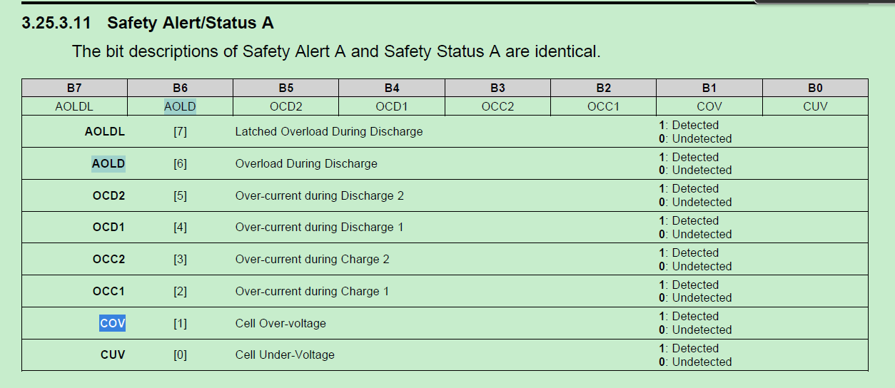

CCS/BQ40Z60: COV safety status
Part Number: BQ40Z60
In my record, i saw CUV in safety statusA is set 1 in section 3.25.3.11 in sluua04d document. And there is no other safety alert or safety status or PF.  I want to ask this is historical record or current condition for FG? And i see when CUV safety status, OperationStatus()[XDSG] = 1. This status means to disable discharging. How does this disable discharge? Will open DSG FET?
