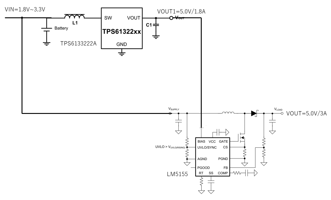

As mentioned in the attached file, the circuit coefficients were determined and evaluated, but it wasn't able to drive a 3A output load with 5V and LM51551 operated in pulse skip mode with 0.4A output load when 1.8V was supplied to VIN.
So, could you please tell me how to improve this issue ?

    Looking at the excel calculator it looks like the current resistor is sized to large. To me this indicate that the LM51551 is running into the peak current limit. Decreasing the value of the current sense resistor to 7mOhm should help the circuit provide full load.
    I would also suggest changing the compensation network to the following value to help improve the loop stablity.
    RCOMP: 1.2kOhm
    CCOMP: 47nF

    Sorry to hear you are having issues getting the board to supply full output power. Based on the quick-start calculator values the device should work. I have a few questions to help figure out what is causing the issue.
    1. What is the maximum output current that is able to be supplied be for the output voltage sags?
    2. Can you provide the schematic?
    3. Waveforms: Please try to probe the SW and CS pin voltage. This will help to see if the device is running into peak current limit or not.
    4. Check the UVLO voltage. Make sure the input votlage is not falling low enough to trigger the UVLO off.

    A1. LM51551 worked in pulse skipping mode with approximately 0.4A output load by using an electronic load when 1.8V was supplied to VIN.
    A2. I will share the schematic via a private message. So, could you please accept my friendship request?
    A3. I will ask our customer to observe these pins.
    A4. It seems that UVLO isn't detected because a bulk capacitor is added to the input VIN.
    I understand that you cannot test this in the lab. So, is it possible to provide me the recommended value for the inductor, resistors and capacitors to convert 1.8V to 5.0V@3A using the excel calculator again?
