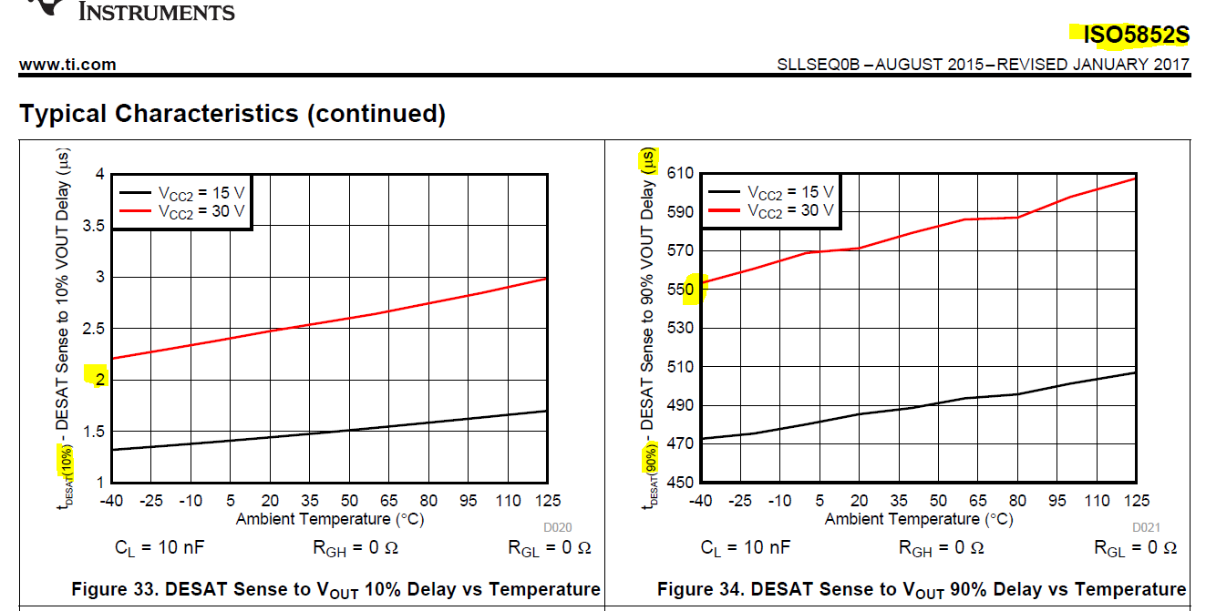

Datasheet has wrong chart apparently :
Fig 33 should be 90% Dsat Drop  , units seem to be ok
Fig 34 should be 10% , Desat Drop , units should be nsec , not useconds
part number is ISO5852S

    The units for tds(10%) is correct; this is in microseconds. The protection feature enables soft turn off when DESAT is detected to pull OUTL low slowly in order to safely shut down the power switch. The pulldown current is approximately 130mA and the load is 10nF. Thus, the timing of shutdown is approximately based on t_shutdown=C*dv/i = (10nF)*(15V-(-8V))/(130mA) = ~2 us.
    This detail is also explained in Section 9.3.4 Soft Turnoff, Fault (FLT) and Reset (RST).

     i agree with you timing for
    full shutdown (90% discharge )  is approx 2usecl
    For Partial Discharge (10% )  should be roughly 500nseconds
    Fig 33 shows graph for 10% discharge and it mentions it to be 2usec
    Fig 34 shows graph for 90% discharge and it mentions 550usecond  not nanoseconds

    Yes, in Figure 34 there is a typo. The units should be 'ns' as is given in the Switching Characteristics table. Thank you for pointing out the error.
