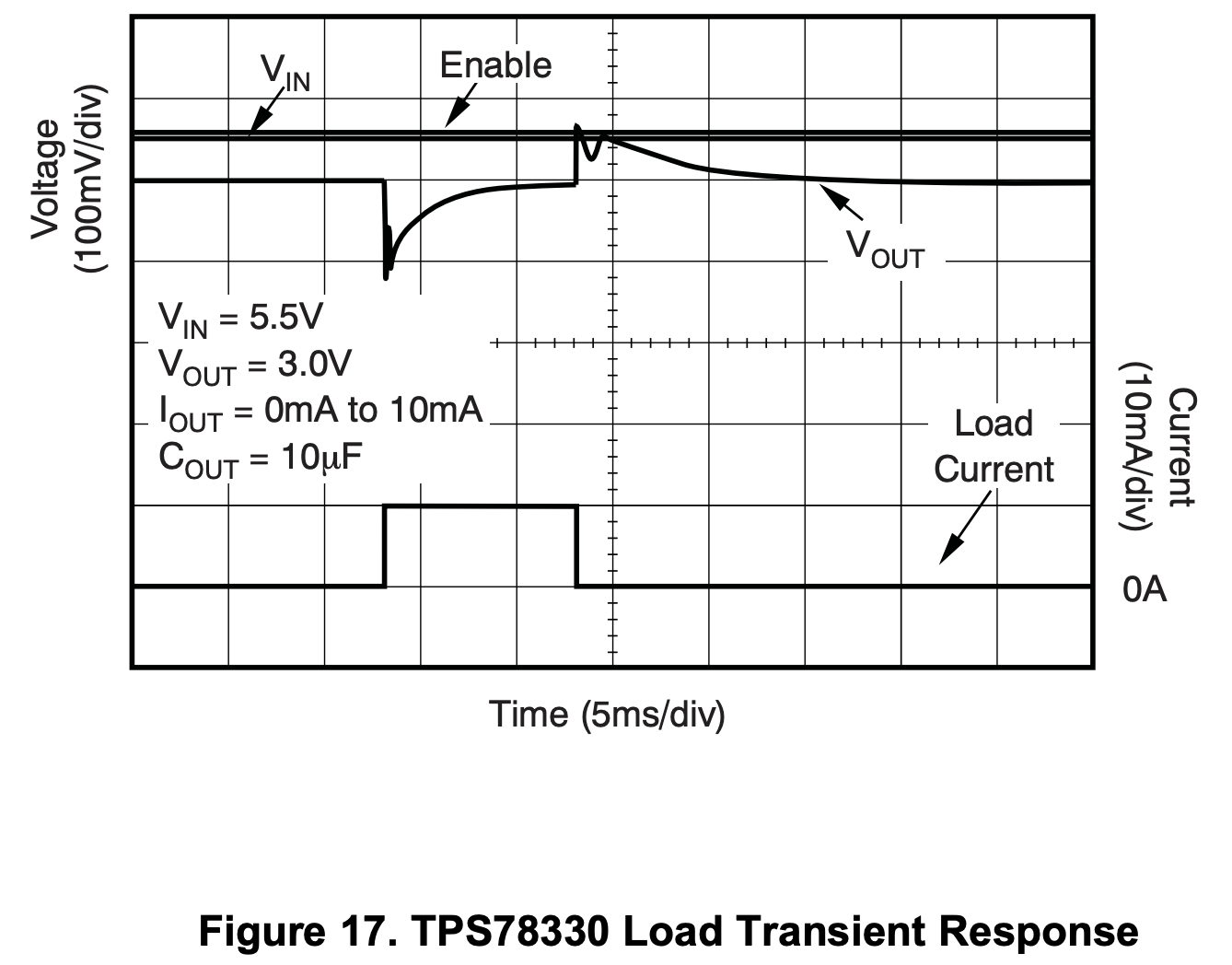

Which datasheet specification ascertains or provides information on no-load stability? For example, a controller in sleep or stop mode uses tens of microamps, which would literally be a no-load to some LDO's. Please note the part number REG113 is NOT correct, it would not let me put the right number there (says no such part) Well, so much for IT automation, folks!
I was specifically looking at this TI device: TPS78330DDCR
