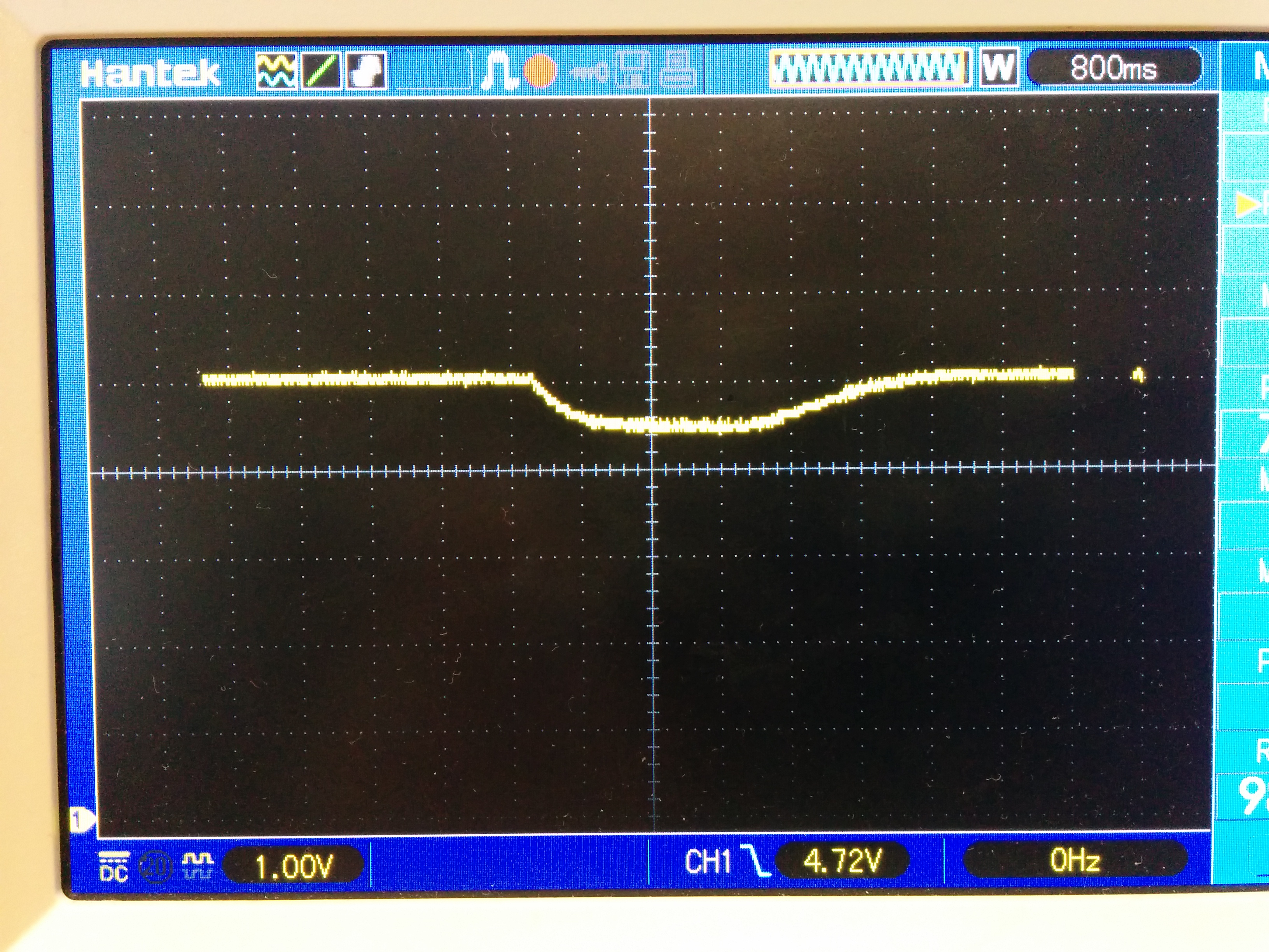

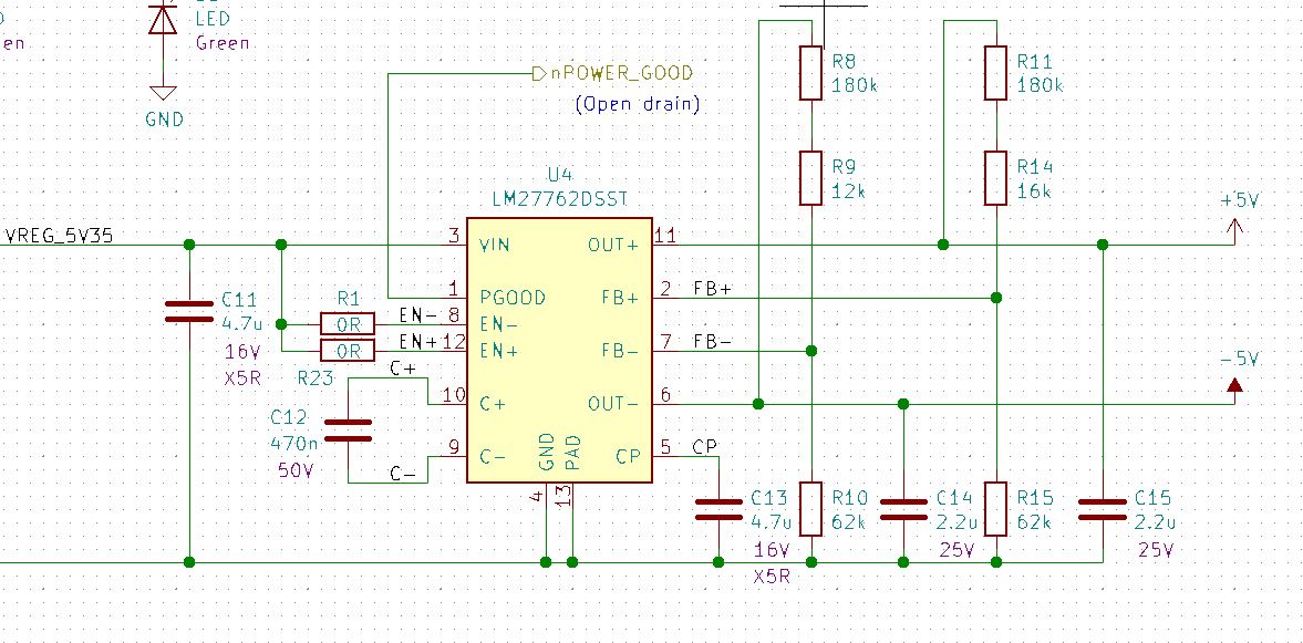

I'm have a circuit generating +/-5V from a 5V35 input. Loading the -5V output causes the +5V LDO output to drop (eg. drawing 200mA from OUT- causes +5V output to drop from 5.04V to 4.56V. (The -5V rail drops from -4.96V to -4.86V). I can understand the -5V rail dropping a bit (my flying cap is 470n, looks like 1u would be better) but I can't see how this could affect the positive LDO, and by so much. The input 5V35 is rock solid. (Again, maybe need to raise this for a bit more overhead for -5V, but shouldn't affect +5V).
C12, C14 & C15 are X7R.
Any ideas what's wrong?
Thanks.
  • ... a bit more information: this appears to happen on 3 out of 3 boards. On the board I'm investigating, I have removed the ICs that are powered by +/-5V. All that is left hanging  on the +5V rail is about 3u3 of decoupling, and an LED drawing 1mA. Applying the load to -5V, the +5V drops in an RC style over about 1 second. Removing the load, it rises in about 3 seconds:
  • ... I increased the flying cap C12 to 1u: The step load drop on -5V halved but the drop on +5V doubled.

  • Hi Brian,
    My suggestion would be to use E96 -1% tolerance resistors for R1, R2, R3, R4 (Feedback resistors: please check the datasheet if necessary).
    Hence please use R1=316k, R3=309k, R2 & R4=100k and try to take the measurements again.
    Please let me know if it works or if you need any further help.
    Febin
  • Hi Brian,
    Additionally, I also guess that the device is running close to 100% mode. (VIN- 5.35V, VOUT-5V)
    So, I would suggest to measure VIN with and without load with the same BOM. It should be lower with a load.
    What is the maximum load applied at both outputs?
    Please increase the VIN slightly (with a load) and take the measurements again. I hope this would solve the problem.
    Febin

  • Hi Brian,
    1. Please confirm you are using 1% tolerance resistors. Have you used  R1=316k, R3=309k, R2 & R4=100k or resistive load? This is very important.
    2. Please use a stable DC power supply of 5.5V.
    3. Can you please provide oscilloscope plots for Vin, +/-Vout, +/-Iout, Cfly with Vin=5.5V, +/-Iout=200mA, Vout=+/-5V, Cin=10uF and Cfly=1uF. The other external capacitors as per your schematic. Please provide plots for both with and without load.
