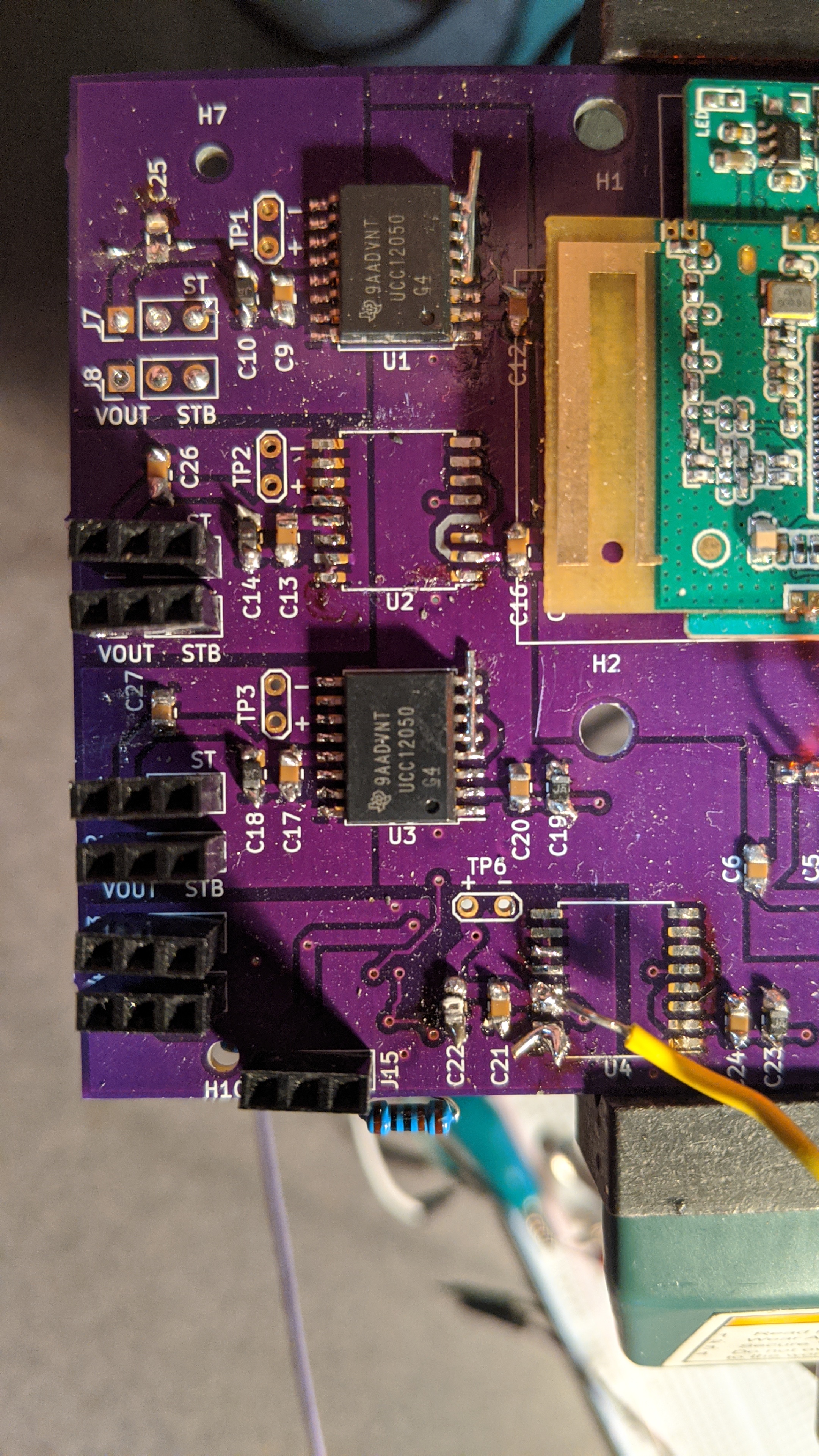

I bought a UCC12050 and have tested it with the recommended application circuit shown in the attached image. I am inputting 5V and wanting to get as close to 5V as possible, so I shorted SEL to VISO as directed. However, I'm only getting 3.3V. Does the input voltage have to be >5V in order to get 5V output? Is something wrong with the application circuit?

  • Hi Ulrich,
    Thank you for the suggestion! I was able to get one to work, but when I placed three of them on the PCB I will be using (with no load), I get ~1.5V from each. I tested and retested to make sure that each was wired correctly, and they are. If there was a load, I would assume that would be the issue, but there's not. Any thoughts on that?

  • Ulrich,
    Thank you for your prompt responses.
    1) I removed one of the isolators and disconnected the other, so that there is only one connected. It is still giving the same voltage (~1.5V).
    2) I apologize for my unclear wording, but the isolators share only the same input (which is rated to supply 2.5A), and their outputs supply isolated loads.
    3) The oscilloscope reading was a constant voltage with not oscillations.
    Attached is a picture of the PCB. Thanks again for your patience and help!
    Jared Curtis
  • Hi Jared,
    Thanks for the photograph.  The resolution is high enough that I was able to zoom in and examine it very closely.
    If I traced it correctly, and if you are using 10-uF SMD tantalum capacitors on each output, then I think C10, C14, C18 and C22 may be installed backwards.  The black case style with white band on one end gives a hint that they may be tantalums. Tantalum cannot withstand high reverse voltage and will pull Viso down due to the limited output current of the UCC12050.
    Please check the polarity of these parts.
    Ulrich
  • Ulrich,
    I switched the capacitors, and it worked perfectly! Thank you so much for your help!
