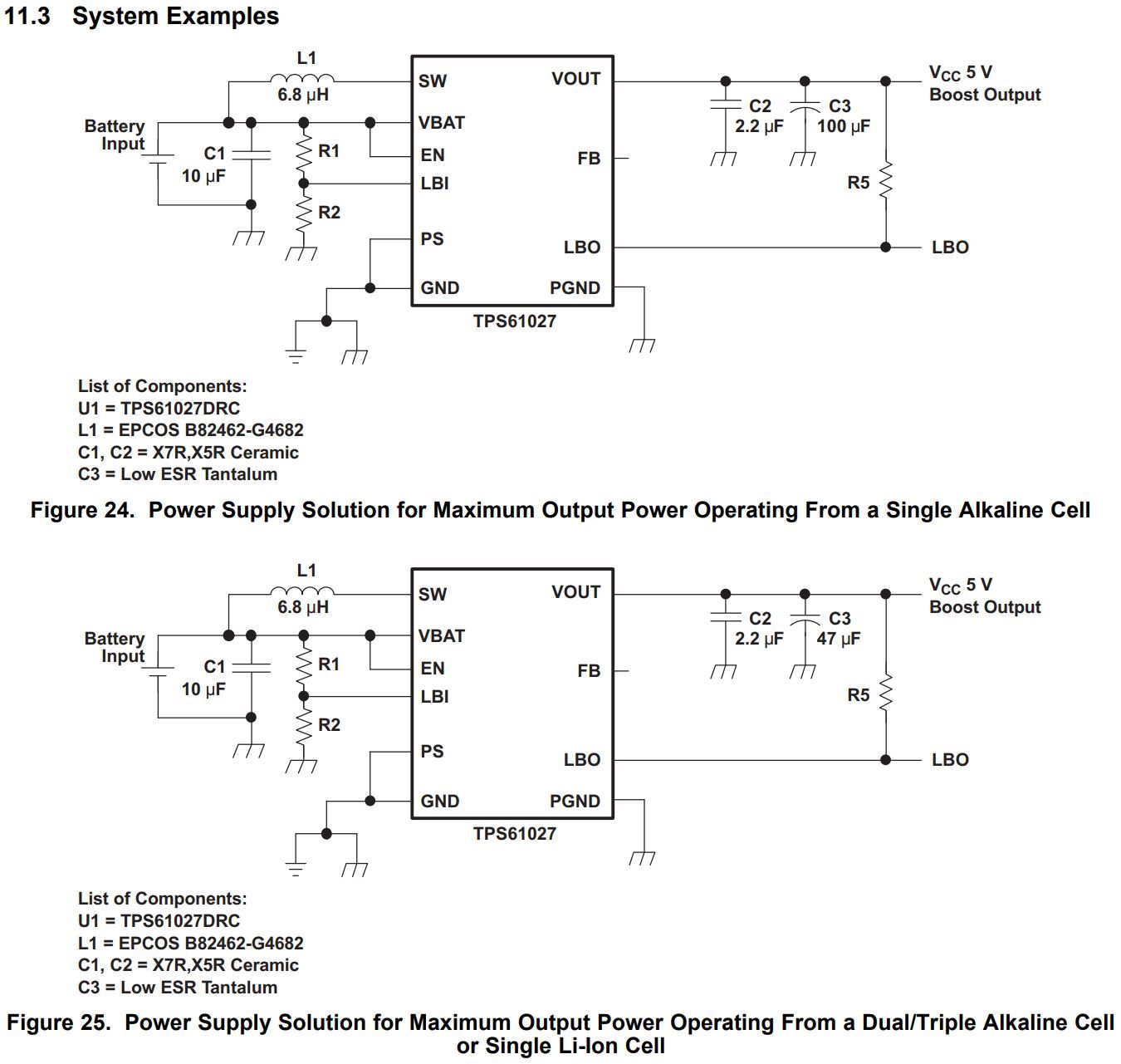

Hi, I am a current student designing a PCB Board for my research. I am planning to use this Boost Converter, but I was looking at the documentation and was wondering for figure 24, figure 25, how do I determine the resistor values for a 4.6V to 5.5V output?
my input voltage (VBATT) is coming from a battery management circuit based from a 3.7 lithium ion battery.
