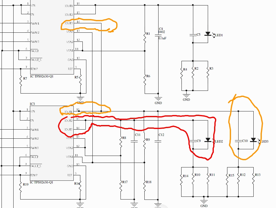

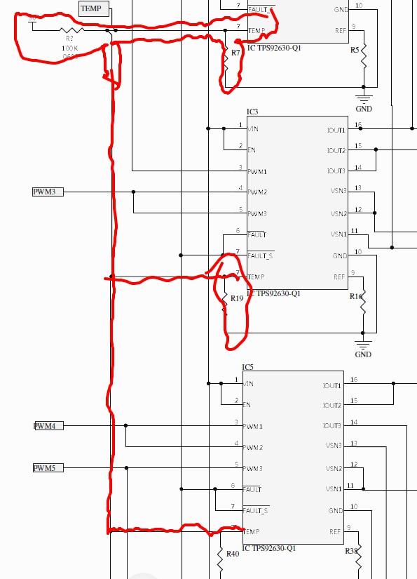

My client talks to me about Thermal Foldback. When he tested, he found that adjusting the Isetting current would affect the Thermal Foldback, and the triggering of reducing the Isetting current to the Thermal Foldback would be earlier trig. Is this the case?
In addition, the customer showed me the schematic. I found several issues that I want to discuss with you.
He connected TEMP together. Can customers connect like this? Or should each IC be connected separately?
In addition, customers want to increase the LED current. Can different TPS29630 supply the same LED?

  • Hi Kami,
    I have some question about your issue:
    1)what the meaning of  "adjusting the Isetting current"? What is the customer's operation?
    2)How the customer measure the result "triggering of reducing the Isetting current to the Thermal Foldback would be earlier trig"?
