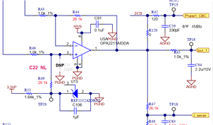

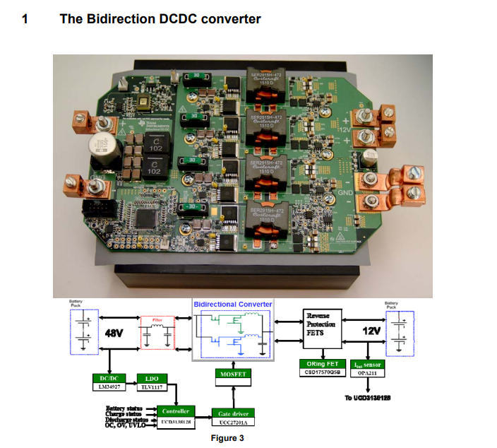

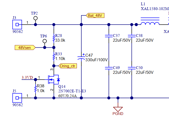

I was recently reading an article about a bidirectional DCDC converter controlled by UCD3138(SLUA765A),I saw a lack of description of the converter schematic in the article.
So I wonder if you can provide the PCB schematic of this converter?I want to figure out how the UCD3138 samples its voltage and current.
