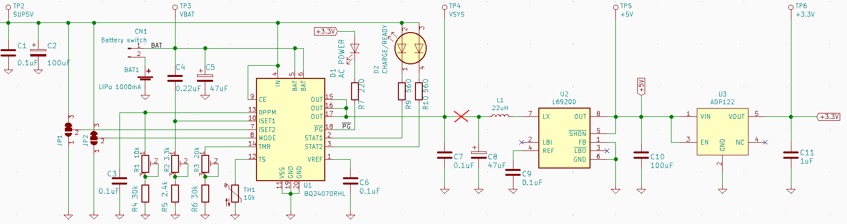

Hello!
1. Please can you help me to check my schematic and understand BQ24070 behavior in charge termination mode? The problem is charge termination status is not activated for hours (checked for 10h at least) on fully charged battery or w/o battery connected. I didn't ever saw any other status than STAT1=ON and STAT2=OFF. Control resistors are adjusted to the values: Rdppm=37k, Rset=3.54k, Rtmr=50k. Voltage at ISET1 pin and battery charge current are goes to zero at the end of charge and Vbat is 4.21V if no load connected (as red cross on the drawing show).

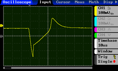

2. When I add a payload with a step-up converter (U2 L6920D) I also faced with a sort of interference on BQ24070. I get a voltage drop about 0.4V at BQ24070 OUT pin at each step-up converter cycle (see the diagram below). In that case, I have a noise about 50mV at ISET1 pin and battery final voltage increase on 0.01V. And I have no idea how to handle with that voltage drops caused by step-up converter. Please give me a guess.

  • Hi Dmitry,
    Just to check that the device is operating correctly, as I don't think I see any problems with your schematic, does the device show proper current when in fast charge mode (for instance when the battery is a 3.5V)?
  • Hi Anthony,
    yes it is. I have discharge my battery down to 3.4V, switch on DC supply, and check battery charge current. It was constant 0.3A as it should be for my Rset value, till ~4V at the battery. I left my setup switched on during the night and have found at the next morning both status LEDs are off, so finally charging was stopped by timer for the first time. But I still had a small charging current about 1mA at my battery and voltage was about 4.3V. Then I made just an off-on cycle at DC supply and have got STAT1=ON signal again for a whole day as usual. But charge current is zero now. It looks like completely broken logic, but I can't understand why. I'm continue some more experiments...

    Can you swap out the battery and use a sourcemeter instead on BAT pin
    WHat voltage do you measure on ISET1 pin when the battery voltage is around 4.2V?
    Also, can you try removing the C4 capacitor and see if that makes a difference?
    From the schematic, can you have the LEDs be pulled up to OUT instead of IN
  • Hello, Raheem!
    Sorry, I don't have this type of tool. But I checked charge cycle with two different batteries: 1000mAh flat LiPo protected cell and 18650 2200mAh unprotected NCM cell. In both cases BQ behaves absolutely same.
    0V (zero)
    No difference.
    I just performed this modification: nothing changed.
    Best regards, Dmitry
  • Hi all!
    Finally I have found the source of my troubles. It is related to DPPM function of BQ24070. For some reason device is not functioning properly for "Charge Done" status detection if the voltage at DPPM pin is set more than 3.71V. Even if my payload is disconnected. I have lowed DPPM pin voltage down to 3.65V and have got working "Charge Done" status detection with payload disconnected.
    But it wasn't enough to work properly with my payload (a step-up converter and a MCU). I still had a big voltage drops on BQ24070 OUT pin at each converter cycle. Then I have increased C8 up to 330uF and that lowed drops amplitude 4 times. Finally, this helped to get "Charge Done" status with my payload connected to the BQ24070.
    Still have no idea, why it doesn't work properly with DPPM pin voltage set higher than 3.71V. Any ideas?
    It looks like the voltage drop on Vout due to the boost converter is causing the charge current to reduce when the device enters DPPM mode. I'l suggest having the VDPPM setting below the voltage drop on VOUT.
    this sounds reasonable. But is it normal when BQ24070 loosing "Charge done" detection capability if it have no any payload and V_DPPM is set to more than 3.71V ? I powering my setup from the 5V 5A lab power supply, set a 0.6A battery charge current and do not see any meaningful noise at BAT and OUT pins. And BQ24070 still stalling with the charge status till timeout happens.
  • This depends on the battery voltage. Termination is nt enabled when the device is in DPPM mode so it's possible for the device to be going in and out of charge modes.
