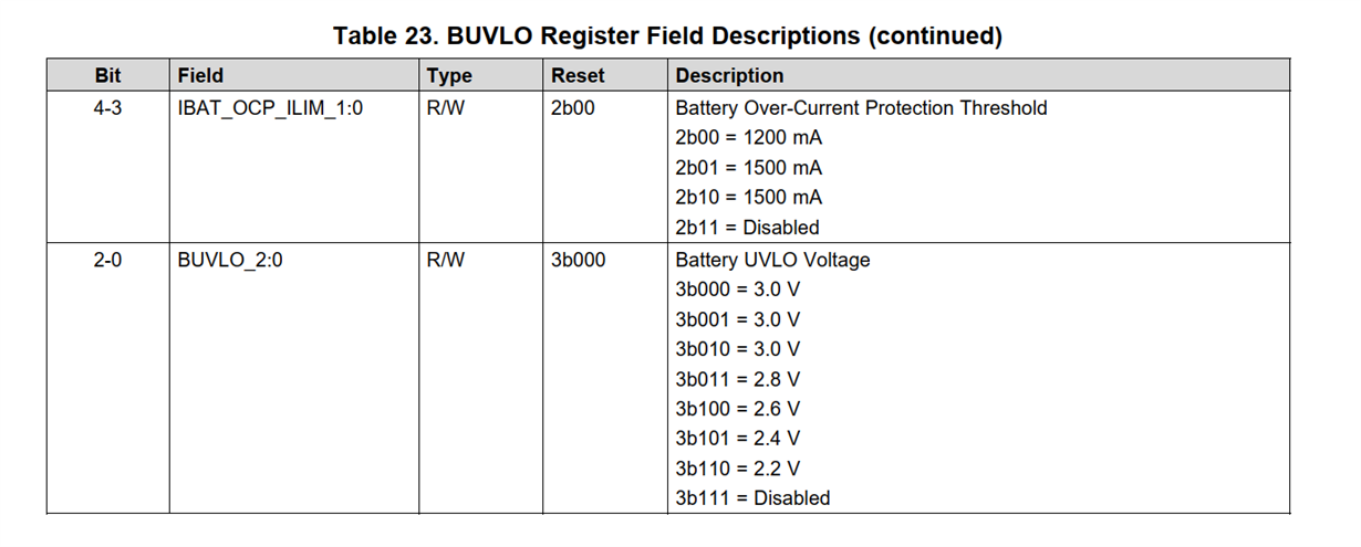

BQ21061: Adjust BUVLO > 3.0V
Part Number: BQ21061
Other Parts Discussed in Thread: BQ25155
Is it possible to increase BUVLO to above 3.0V? Further is this from the datasheet accurate?  It seems strange that there are 3 settings for 3.0V and none that are higher
    There is no higher setting than 3V for BATUVLO. If you require a higher voltage, you can use switch to the BQ25155 and use the ADC and comparators on that device to go into shipmode when the battery voltage goes below a certain level.
