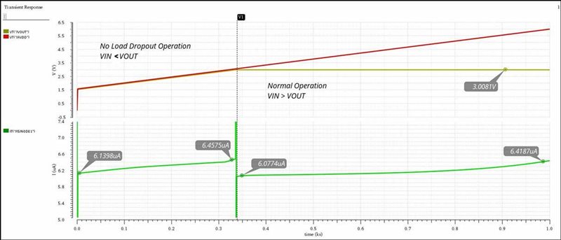

    Regarding the TPS7A20 I notice the line in the data sheet for Ground Pin Current in dropout states a maximum of 20uA, is this effectively the maximum Iq under these conditions?
    Patrick
  • Hi Patrick,
    This is the worst-case no-load IQ under normal operating conditions.
    I was able to get this simulation of the TPS7A20 showing the behavior as VIN rises through 3.0V (VOUT set to 3.0V).
    I hope this helps.
