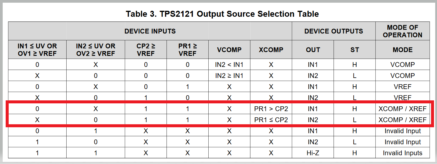

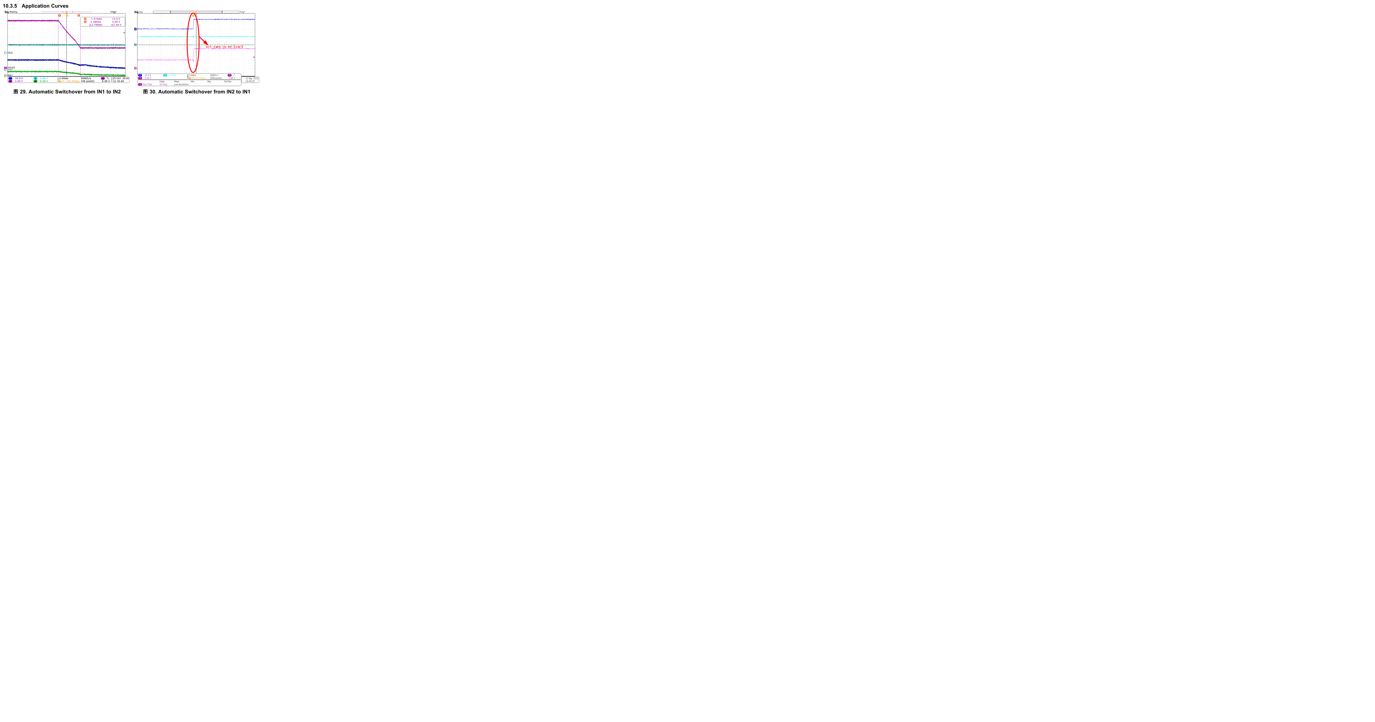

    In order to achieve the desired functionality, the TPS2121 will have to be in the XCOMP/XREF mode of operation. This mode allows for a fast seamless switchover between inputs, typically 5us, in order to provide uninterrupted power at the output. More details on the XREF and XCOMP modes of operation can be found in pages 20 and 25 respectively in the datasheet.
    I would suggest the XCOMP configuration to give one of your power supplies priority when present. In order to ensure functionality in the XCOMP mode, a voltage greater than Vref = 1.06V has to be applied to the PR1 and PC2 pins of the TPS2121. This voltage will be applied through a voltage divider from IN1 and IN2 respectively. With the proper voltage divider configurations priority can be given to any of the input sources. When the voltage at PR1 is greater than CP2 the TPS2121 will output IN1. In the other hand, when PR1 is less than CP2 the TPS2121 will output IN2.

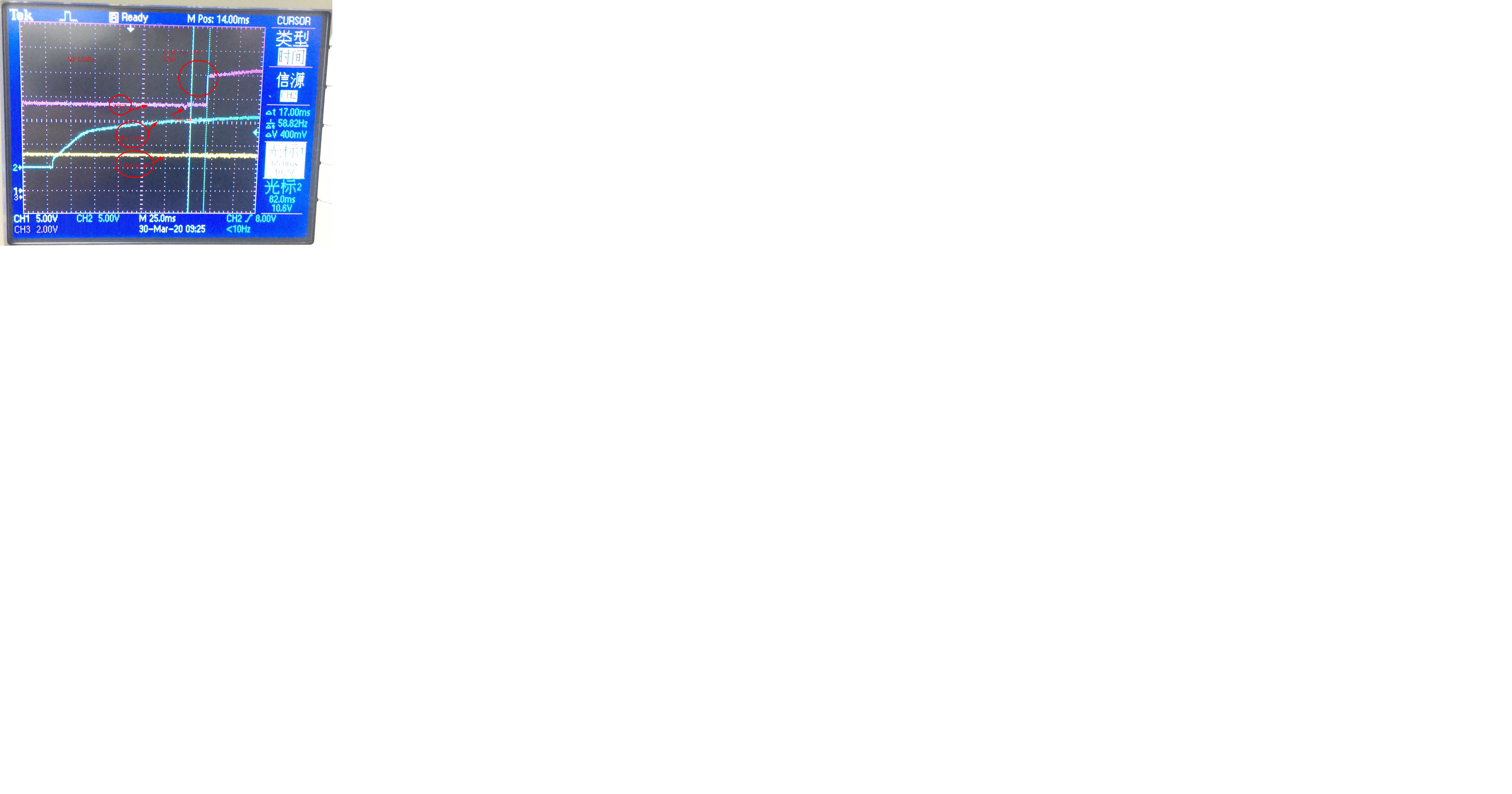

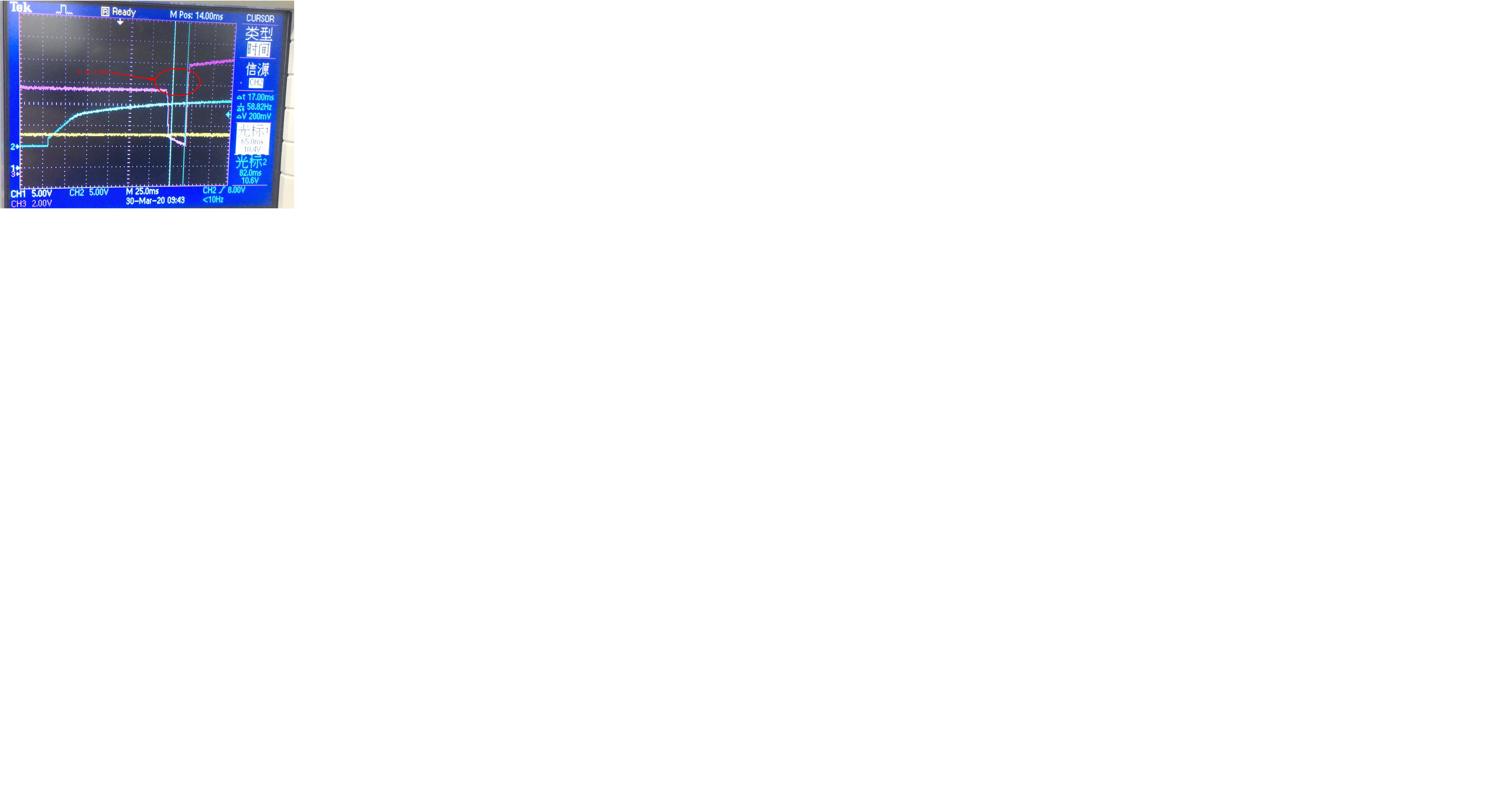

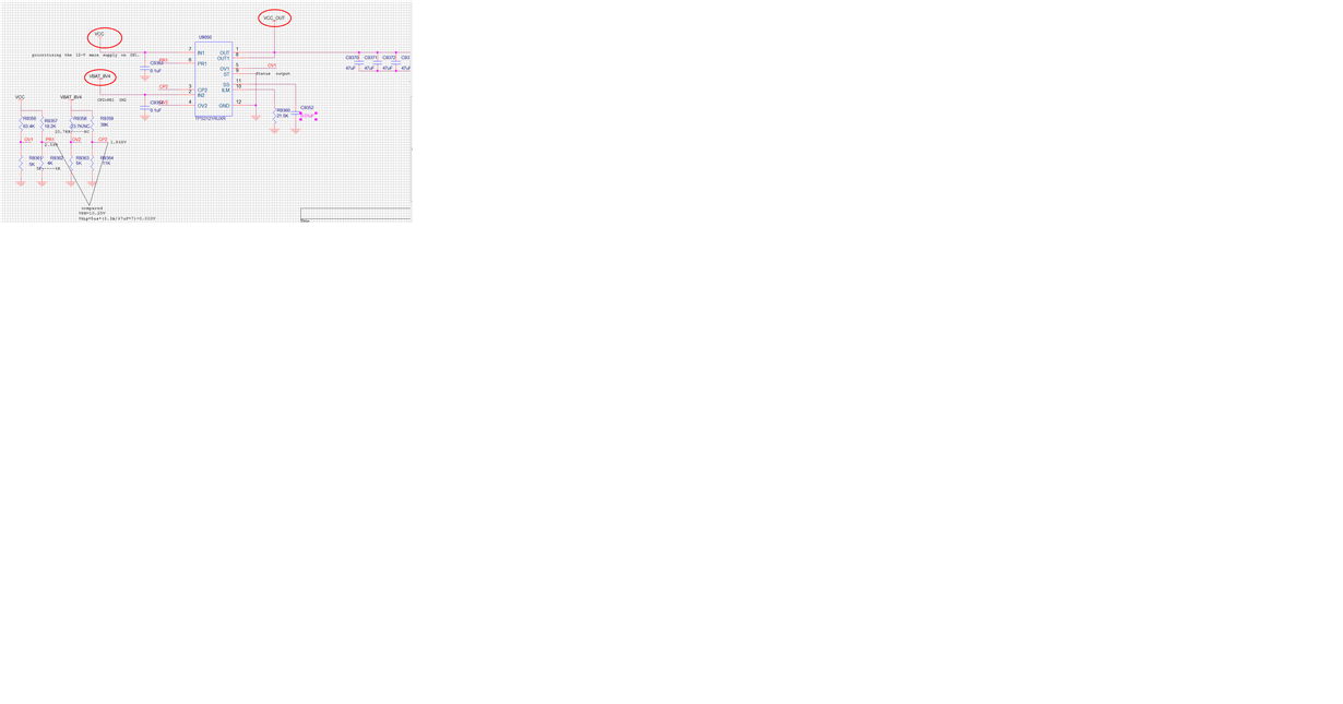

  • Im test on my board  :picture 1 has no loads;2 has 0.3A。3 is my SCH
    The device seems like its functioning as expected without the load. This means that the load current is affecting the device and causing it to shutdown.
    The device is more than likely shutting down due to its relative thermal shutdown protective feature. Relative thermal shutdown shuts down the device when the temperature of the FET of the active power supply rises 60 degrees Celsius above the rest of the die. In order to mitigate this rise in temperature we need to address the inrush current.
    Could you test the set up and decrease the output capacitance and share your results?
    Would you be able to measure the current on VIN1=12V to see if we can capture the inrush current going into the system?
