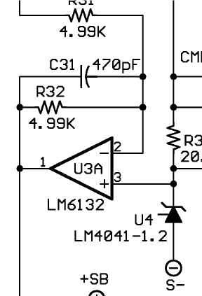

I have another question related to the feedback loop of the Eval. After the type III compensator there is an additional filter:
What is the function of this second stage?
